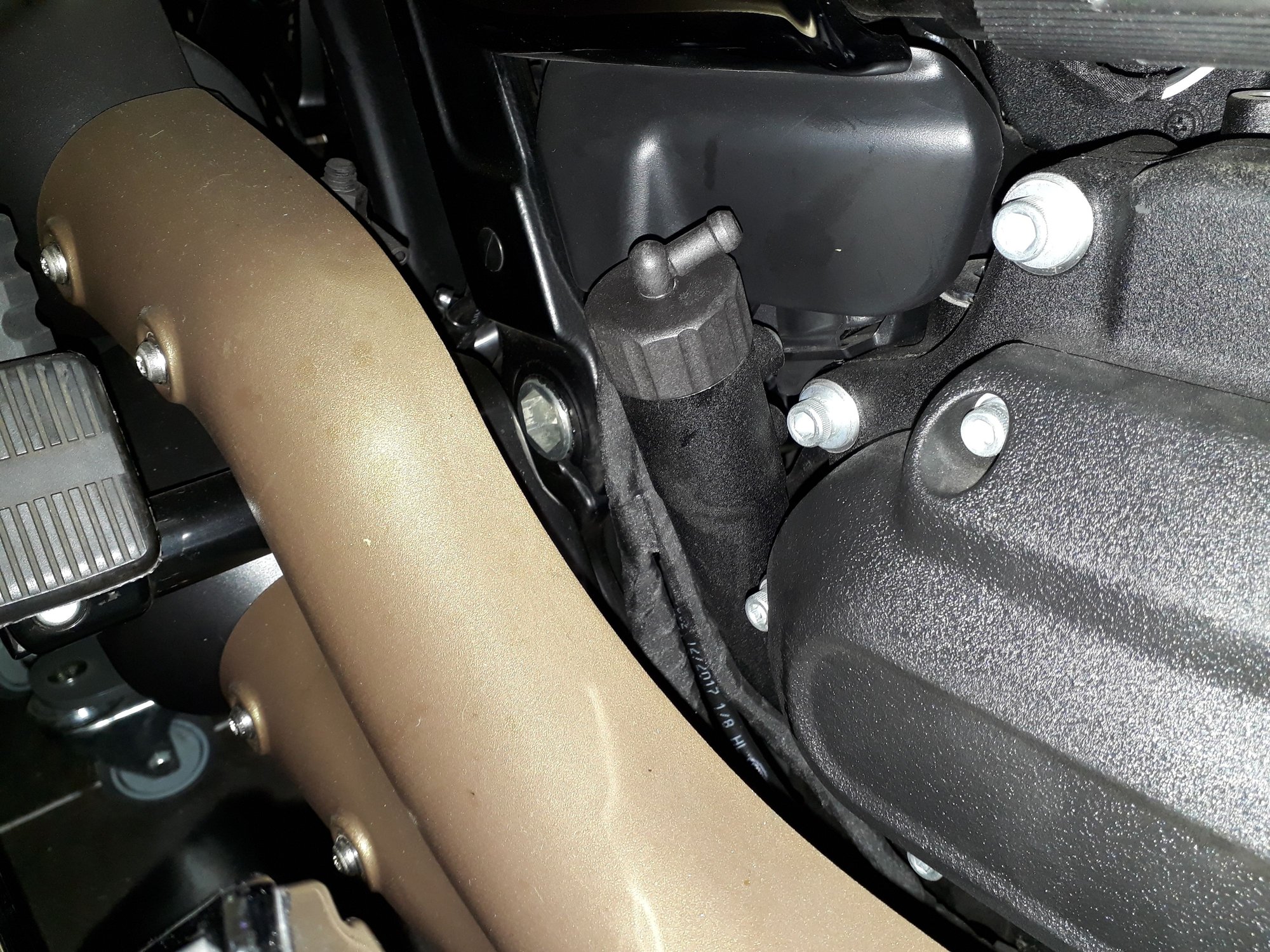

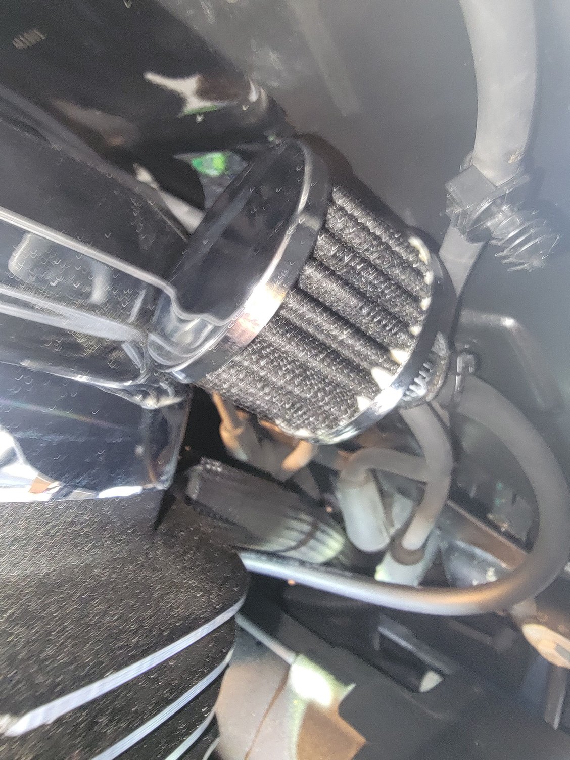

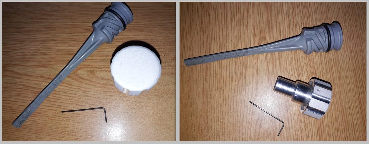

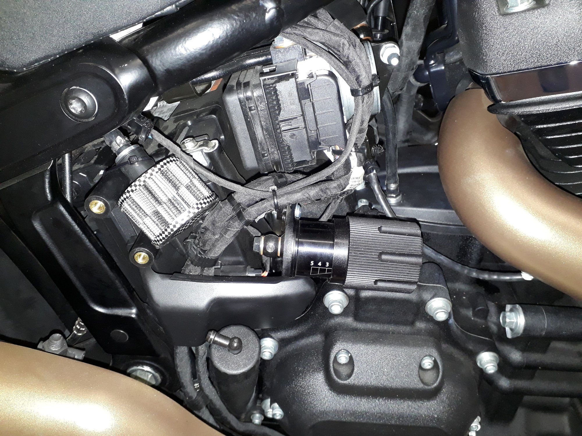

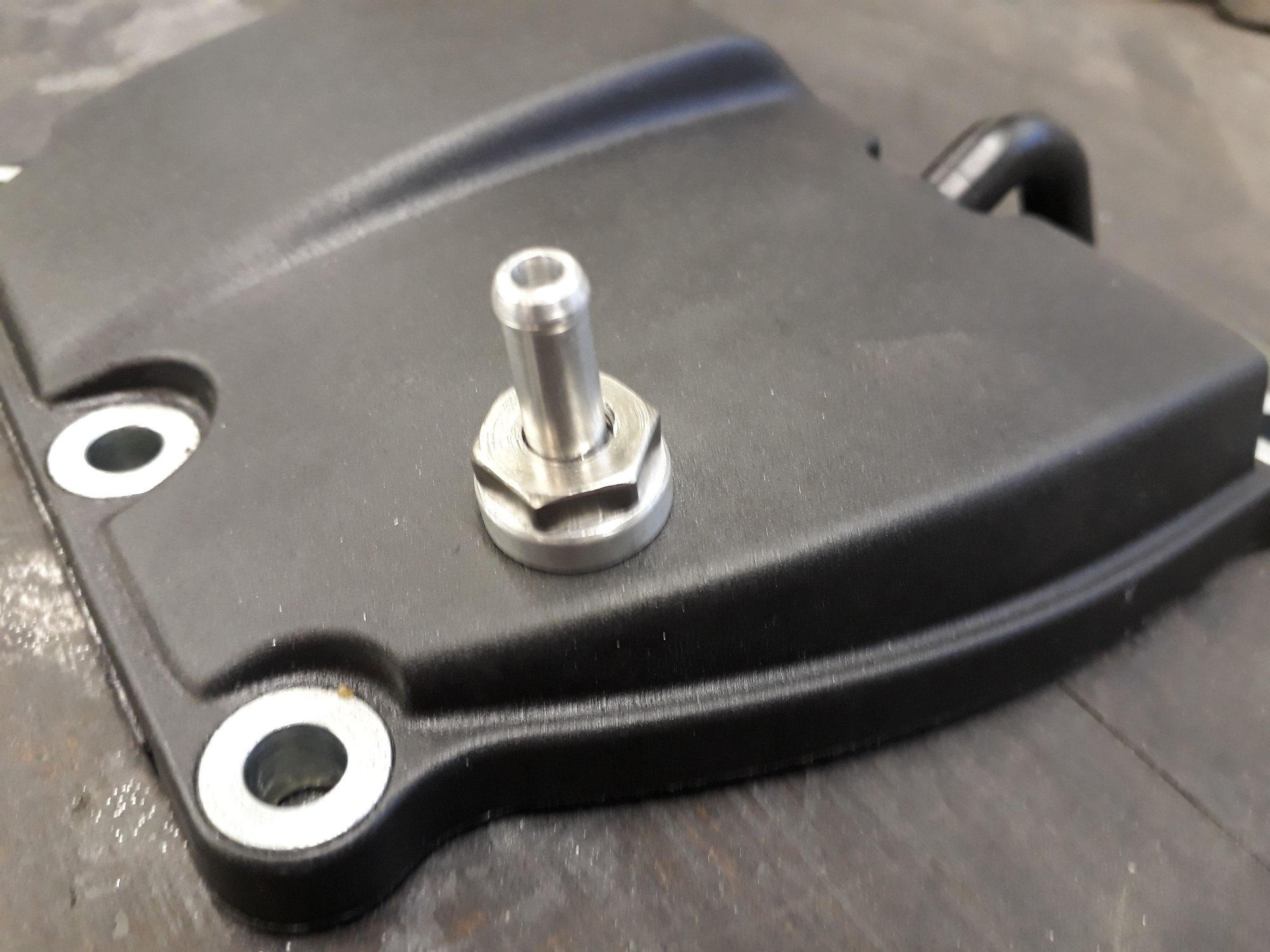

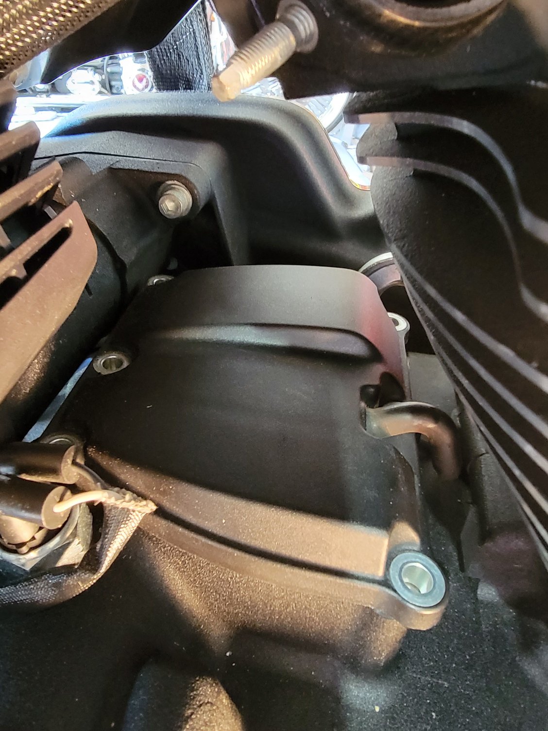

Made several of those things, for some friends and my own bikes.
This is a one way valve I made, it fits in the "trow a way" filters like I call them
Here installed on a FXFBS
I also made some vented dipsticks with a one way valve in it
That looks awesome, you should sell them.

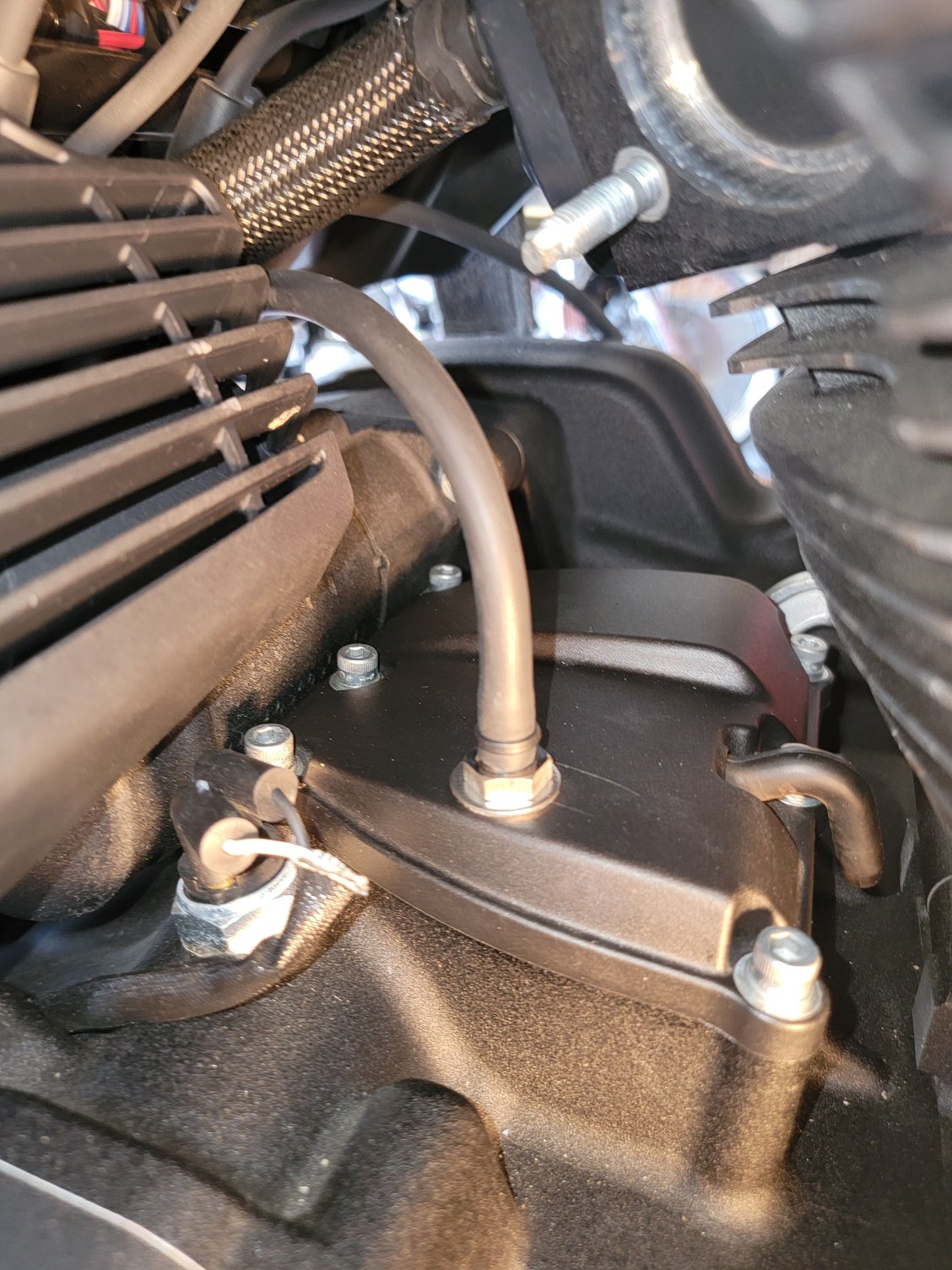

Done correctly a home built system works just fine. My reason was I was fed up with air cleaner misting oil onto my leg - long day hot weather. First step venting the a/c overboard. That drizzle under the frame made a mess. Next step my home built Trask substitute as I described earlier, with a catch can. The key is using a robust check valve & I like the metal reed valve since it works long term for rapid cycling pressure on/off.
If the motor is pressurized you have the valve backwards!
So, no more oil on me, the frame, the saddlebag. Also, a vented motor with check valve keeps a slight vacuum inside the motor easier revs an old hot rodder method used for decades.

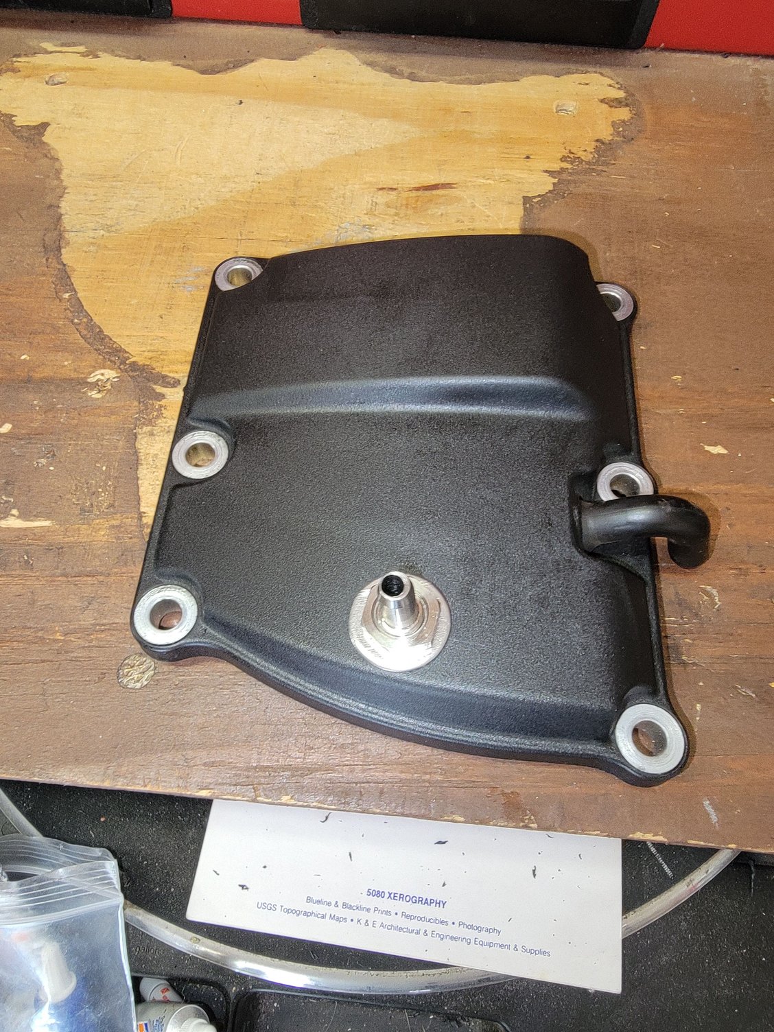

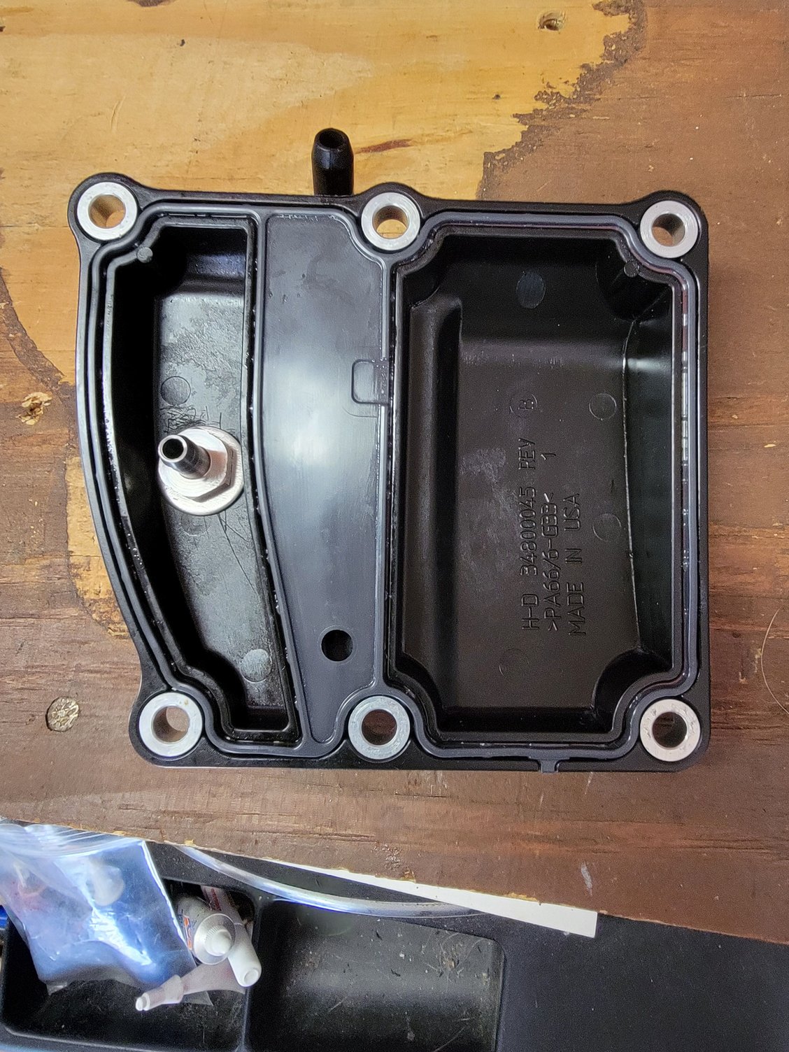

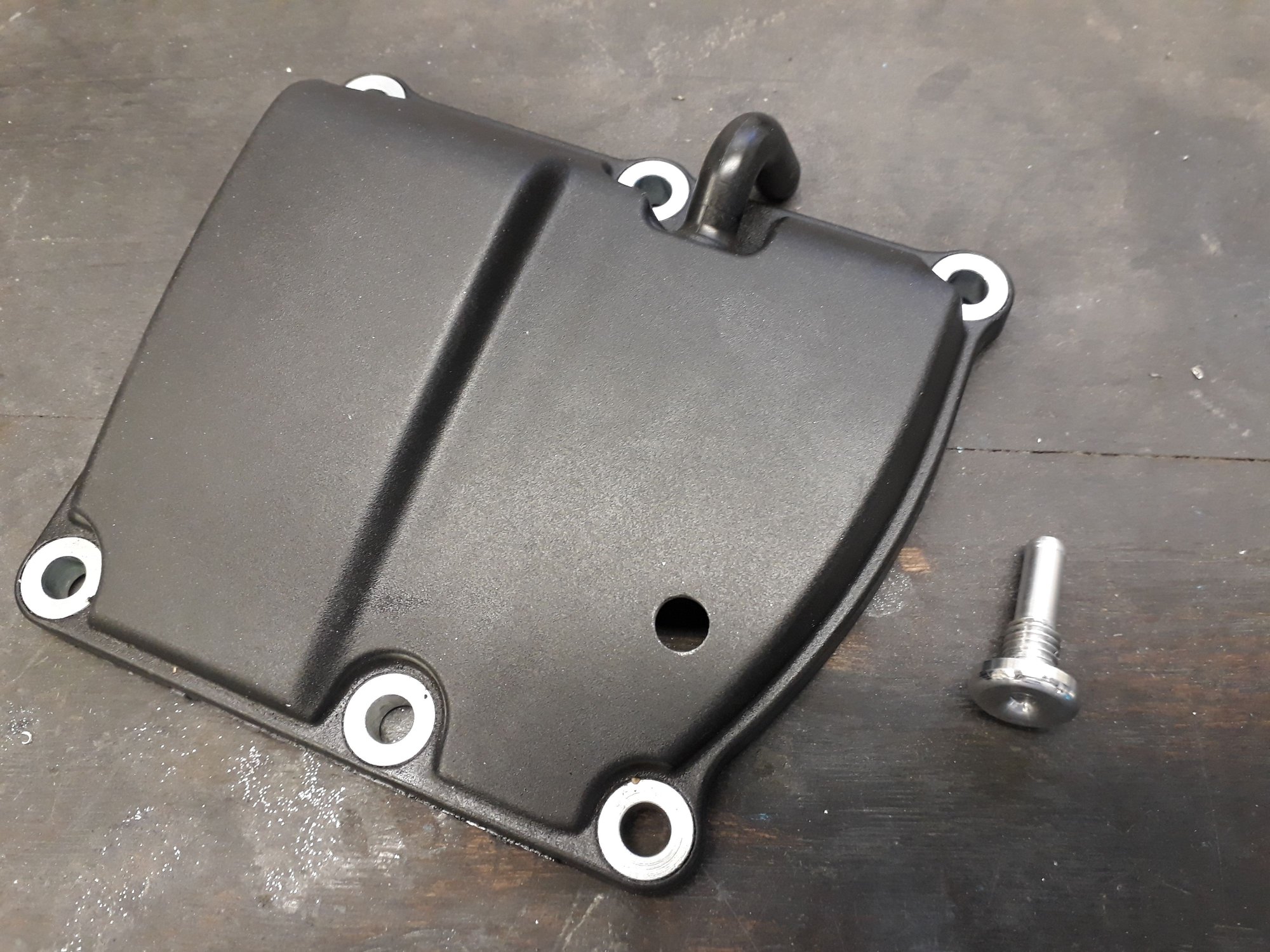

If you have a 2017-2019 touring bike, you'll also need to punch a hole in the gasket. See post #21 below: https://www.hdforums.com/forum/touri...l#post21555291
There was a change in the touring trans top cover, I THINK in 2020. 2017-2019 touring top covers will not work for venting crankcase due to the internals of the top cover changing.
In 2020 the touring trans top cover switched to the softail trans top cover.
34800038 is the 2017-2019 touring number.
34800046 is the 2020+ number.

Originally Posted by Cornpipe;[url=tel:21532036
21532036]… I vented from the top of the trans case.
