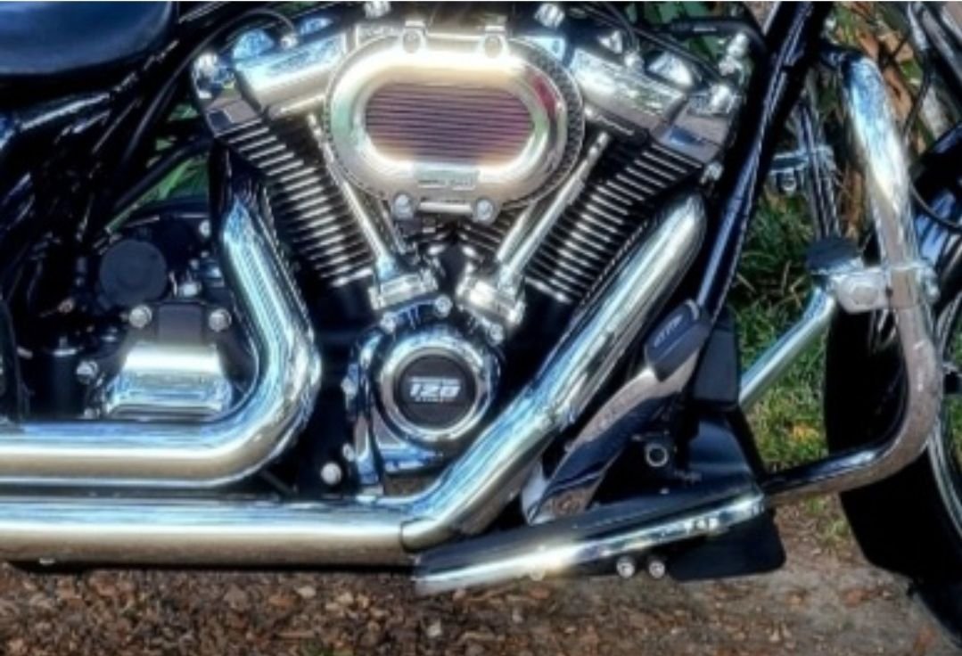

I as well love my tallboy extensions on my 2019 FLHR.
But as I come from the old school chops from 60s and 70s the brake pedal is back to normal as that was the way they were on all the forward control choppers (such as easyrider) and most them bikes had no front brake.
With our front brake being the stopping power we have plenty of time to get foot right with brake pedal. So majority of riding time brake pedal is out of the way.
One of my favorite parts is being able to slide my foot underneath the brake pedal all the way to stretch out my leg. Just do yourself a huge favor and let it ride for a while and you will learn to love it that way and braking will be normal.
PS
I haven't scrubbed floorboards or brackets with about 4k miles so far. Added a set to a 2012 Limited @ same time and he isn't dragging either.
Here is brake pedal on my old 74 (still have her) and pretty much how all forward controls were back in the day.

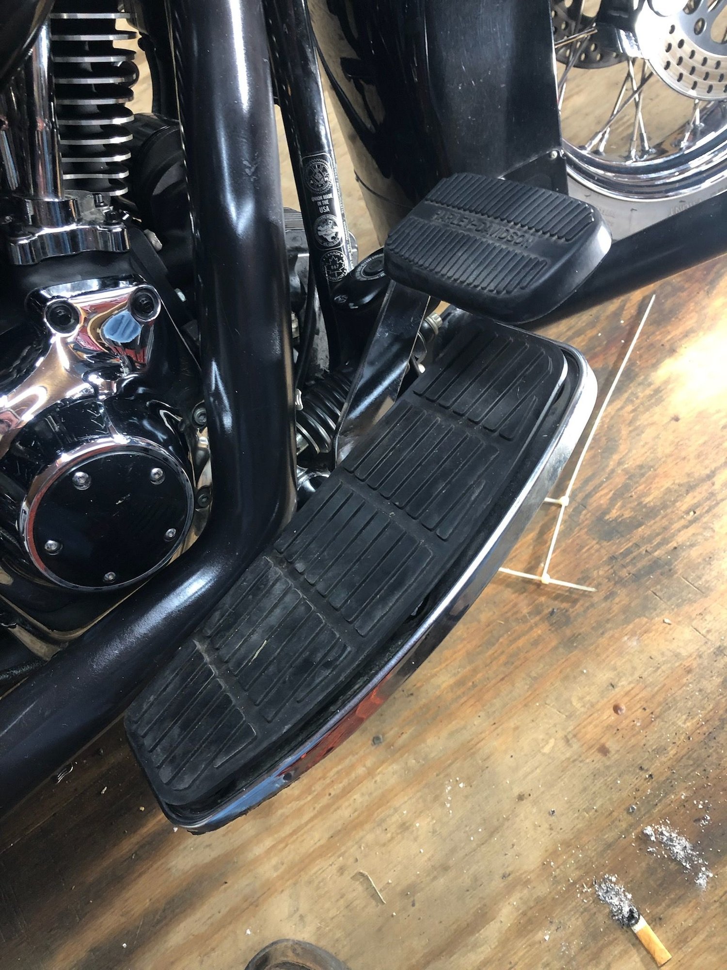

Did that last week, worked fine
Did the "v", bend then weld?
​​​​​LOOKS GREAT and what a savings!
Also, my opinion is that fat brake pedal looks great with the stock floorboards! Damn sure looks better than sticking up like mine!
Always polished my work when dealing with chrome as such best I could and then clearcoated it for protection.
Did you use the tallboys?
There is much more of my brake arm showing than yours (but again to my liking for stretching legs further forward).
