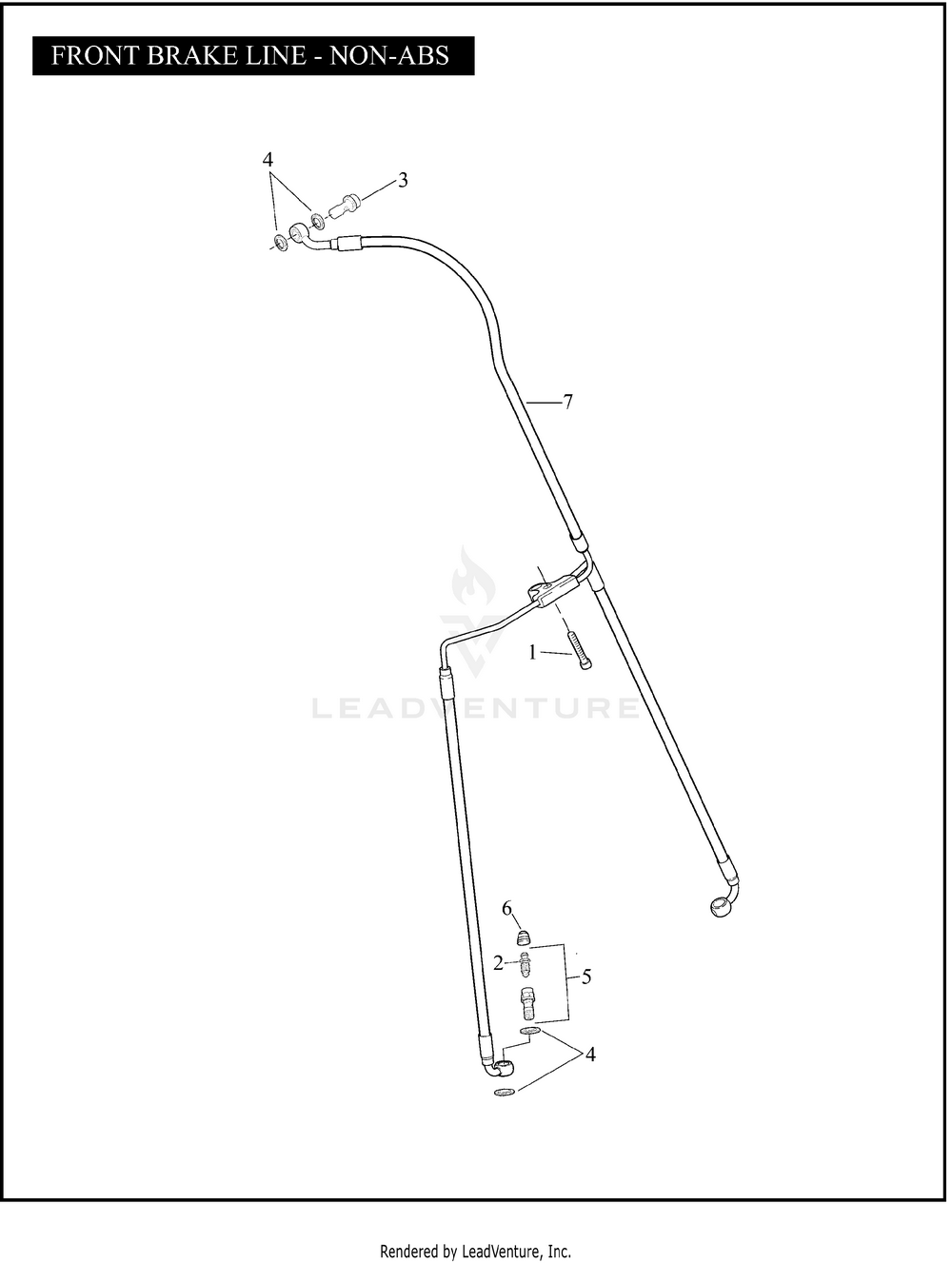

1. That year and model also came without ABS.
2. The previous owner probably had a dealer with a digital technician or an independent with the appropriate scan tool change the settings to non-ABS so no codes etc. show up. Looks like the ABS elimination was done the correct way.
3. Ride on and enjoy.

You said, Looks like the ABS elimination was done the correct way."
I respectfully disagree..... IMHO, the correct way would have been to flash the ABS light to off, AND replace the ABS lines, with the proper non-ABS lines as you showed in your pics.
Obviously more work & money in the "correct way" but it removes all the extra fittings and potential leak points from how 81shovleheads!'s previous owner did it. The previous owner just removed the ABS module and then connected the ABS lines' fittings together so the ABS brake lines functioned like non-ABS brake lines... That IMHO is sloppy work and a short cut.
It would certainly work, but I consider that a "mickey-mouse" repair, not the "correct way".. (does anybody still use the label "mickey-mouse" for a short cut, and/or sloppily done mods?)
I offer this critique of the way it was done in 81shovleheads!'s picture by the previous owner, for anyone wishing to eliminate the ABS module in the future... Like Sc0- mentioned in the above post..
