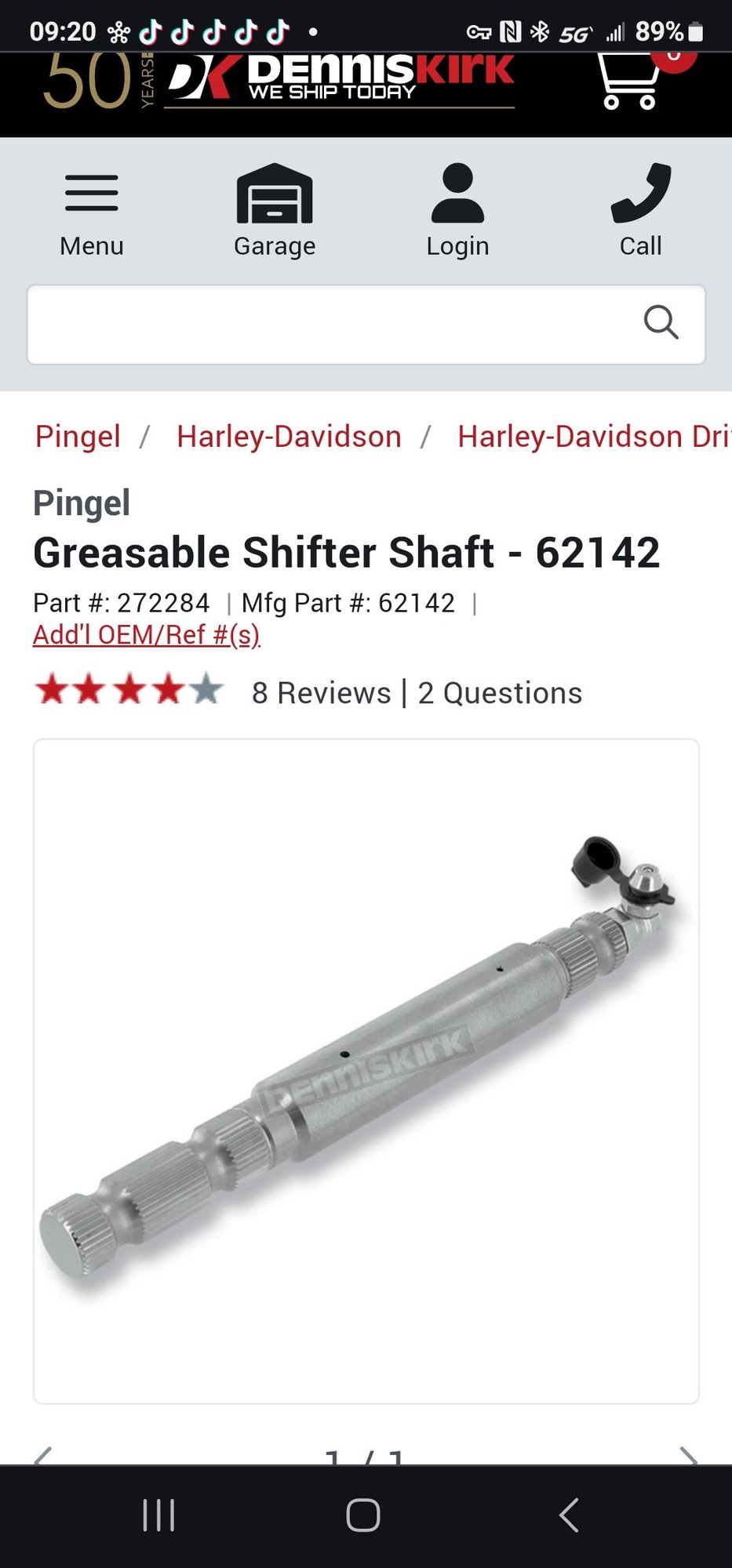

Here's your part. Harley doesn't seem to think it needs grease so you have to go aftermarket

And you have about as much into your mod as I do. Like maybe $2.50? And if the shaft ever wears out, it's only $25 for a new stock OEM one, not $100.

I find it funny that so many are opposed to spending for the shift shaft that you would never have to replace, but are willing to spend even more for the tools to change the bushings.
The shift rod with heim joints cost more. But I don’t hear anyone complaining.
Or how many guys drop 500 bucks on a farkled air cleaner set up? I guess it is more noticeable than a shifting shaft with a grease nipple.

I find it funny how many people will drop a hundo on a fancy shifter shaft when a 5 cent zerk does the same job (and, in my opinion, looks better).
