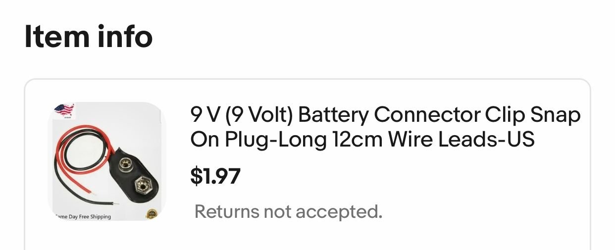

Originally Posted by barneyboy
It looks like one of your connectors is missing. There should be two on there.
eBay to the rescue.

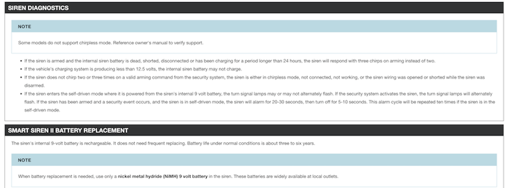

with no siren, it is not necessary to disable the security. but it is a good practice to get into. if you ever put a siren on, and go by habit and just disconnect the battery, the internal battery in the siren will supply power and the siren is very loud in the garage.
Originally Posted by Rocking_it
I went years without knowing there was a battery in there. Will now replace every time I have rear tire off.
no, don't do that. it isn't necessary. it is not a standard 9v battery, and if you buy it from the dealer, is over $50. it's rechargeable and can go many years without needing to be changed, i've had mine for over 5 years now. let the bike tell you when necessary.

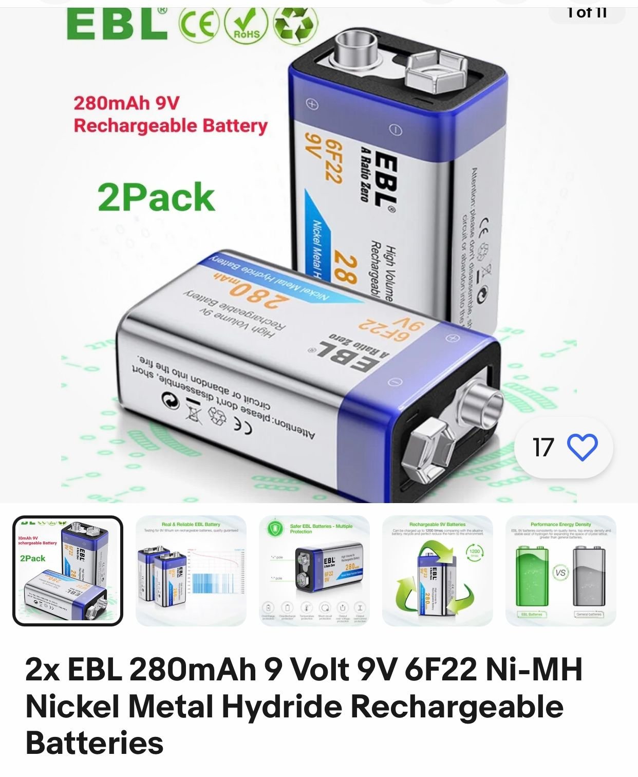

I’d probably disable the alarm before paying that much. Someone recommended this battery on another thread so giving it a try.

I think I'm using those. Been about three years on the first one and I think it was a four pack or something...
