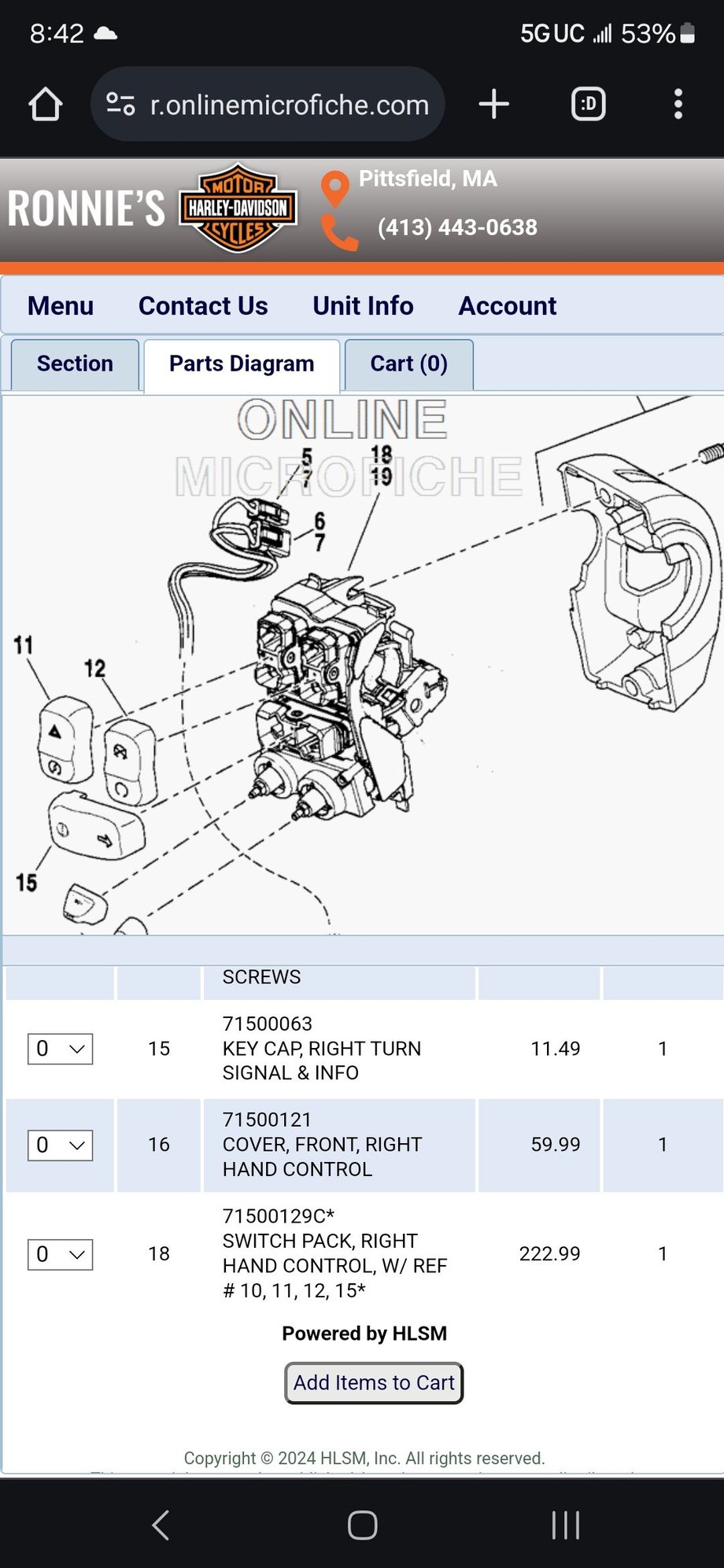

Anyone got a part number for the switch? The one on the left, hope they come separate!

I can see a real reason. You can't lock it out. Now it won't Starr bur left in gear, if someone hit it, it's going to jump. And if stand is not locked in, it's probably going to go over.
That a pretty expensive part.
https://partsfinder.onlinemicrofiche...rleydavidsonmc
