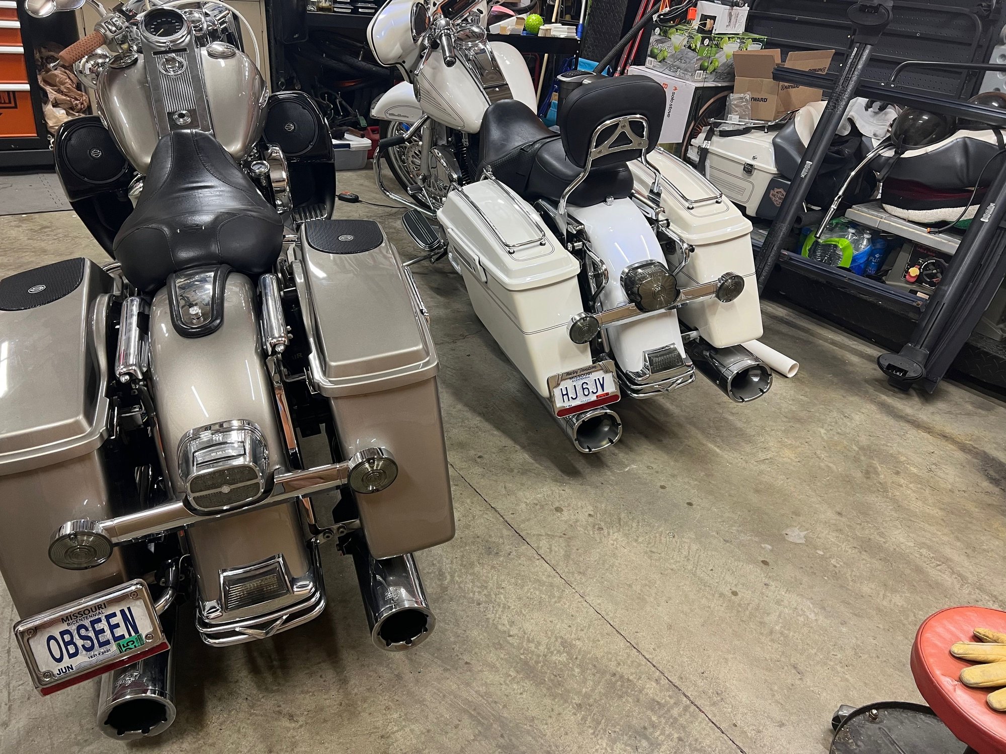

Originally Posted by Sevenznuf
how much did it actually lower your bike in total?
Just to follow-up and give a bit of perspective.
This is the 'parked height' of the two bikes. It's not the best way to see the difference...but if you look at the height of the clutch-side exhaust tip (to the floor) on each bike...it's gives an indication of how much each set-up changes versus your stock shocks.

My main concern is how much it takes away from the lean angle, did it affect it much?
I've never had issue. But, I'm not an aggressive rider.
