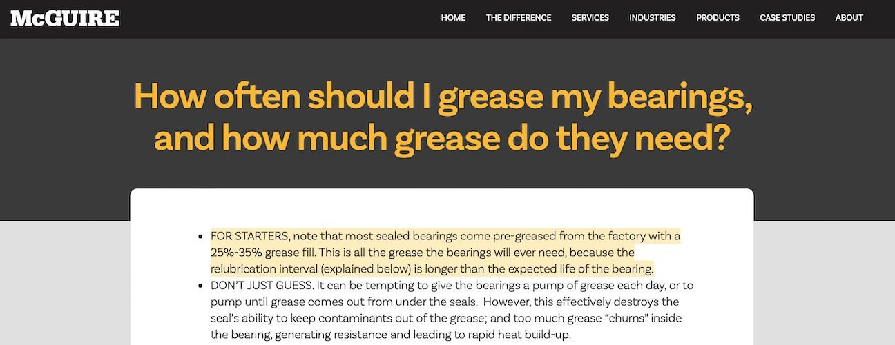

While this is hotly debated, and you can find "experts" that will argue both sides of this debate.
For my part, IMHO, I do not believe it is wise to open a sealed wheel bearing and add grease.
From what I have found researching the topic, most experts agree that the sealed bearing does not need to be packed full. In fact many say a fully packed sealed bearing will be a bad thing... The fully packed bearing leads to increased friction and heat, which shortens the effective life of the grease. I've attached at the bottom of this post, something I found in several sources stating that the sealed bearings need no more than 25% - 35% grease fill under the seals.
Also, there were several sources that state how easy it is to damage the seal(s), causing water intrusion, which is a big bearing killer. The video below demonstrated this.
Finally, again IMHO, many of the early bearing failures on the HD 25mm bearings, I believe were due to improper installation with a installation tool that only puts pressure on the outer race of the bearing, instead of both the inner & outer races equally. There are many people, and I was one of them, who use one of the poorly designed tools. I was educated by multihdrdr and Max Headflow about the issue and the risk they pose during install.
https://www.hdforums.com/forum/touri...ng-tool-5.html
Here is a video I found, and this guys states the way many feel about the entire greasing a sealed bearing debate.
Below is the info from McQuire Engineering Services and X Anderol about overfilling a sealed bearing.
Of course, I have only shared info supporting my personal opinion. I offer it as a counter point to many who routinely post, and believe it is OK, if not necessary, to ad grease to a new sealed bearing. I am not trying to demean their opinions, just offer an opposing opinion.
As always, I suggest people do their own research, think for themselves and form their own opinions..
