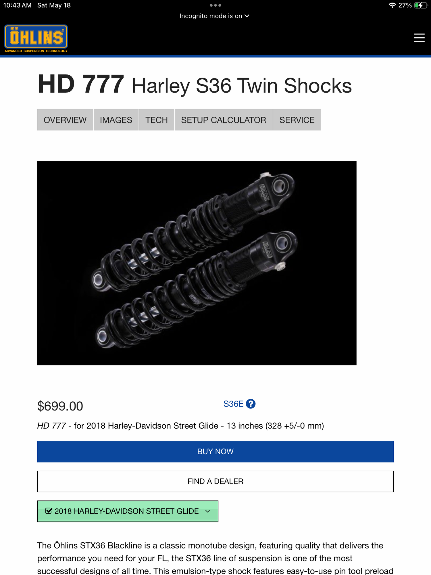

If you’re dead set on Ohlins then you might have to ride a bit further. I would call Ohlins
looks like there are a couple of dealers in Halifax and a couple in Moncton, the difference In travel and currency exchange might not be worth going to Orono Maine which Is the closest Ohlins dealer. If it was me I would look at the HD039 or the 777 series. The cartridge style shocks are good but your on a Harley-Davidson not a sports bike. The 777 is 13” and i believe you would benefit from that extra it of travel
