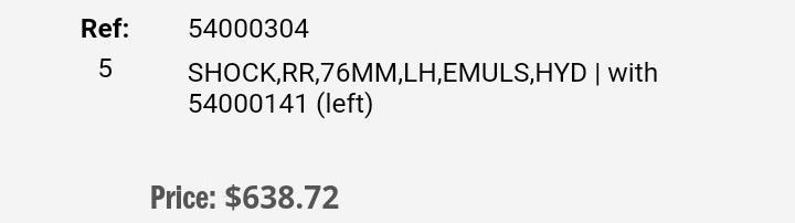

There has to be some internal difference between the new left side shock, and the current shock used on the FLHTK. Besides a different part number, there's a significant increase in price.
2024 FLHTK left side shock:
2024 FLHX/FLTRX left side shock:

[QUOTE=barneyboy;21684660]There has to be some internal difference between the new left side shock, and the current shock used on the FLHTK. Besides a different part number, there's a significant increase in price.
I had wondered that also and today I found out at least one significant thing: the old LH shock rod is I think 40mm diameter and the new one is 70something, almost twice as thick. I forgot to ask about the spring and adjustment **** if there was any differences with those. And the new ones are 13” shocks.

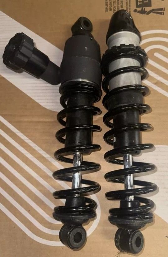

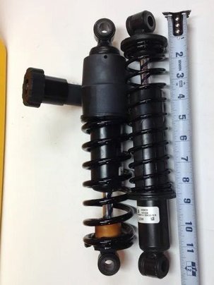

[QUOTE=Classic 10;21700010]
Could you point out the "shock rod"? Top photo is a set of take offs from a 2024 Street Glide. Bottom photo is a set from a 2023 Street Glide.
