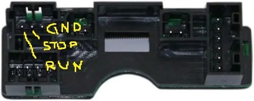

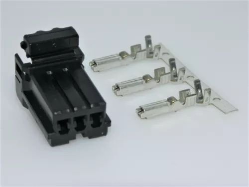

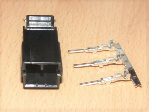

you can put it with no problem since 06-08 street glide fender mounts same way as any other 98-08 touring model. You can use your existing tail light and fender harness. Biggest issue would be to connect the fascia light. On SG it connects to the tour-pak light connector which your bike doesn't have. Most simple way is to replace the male 3-pin multilok connector on the fascia light with same female and connect it to the fender tip connector on the tail light board (it even has a stoplight output should you decide to use accessory fascia light with run/stop function).
replace this
with this
and connect here
