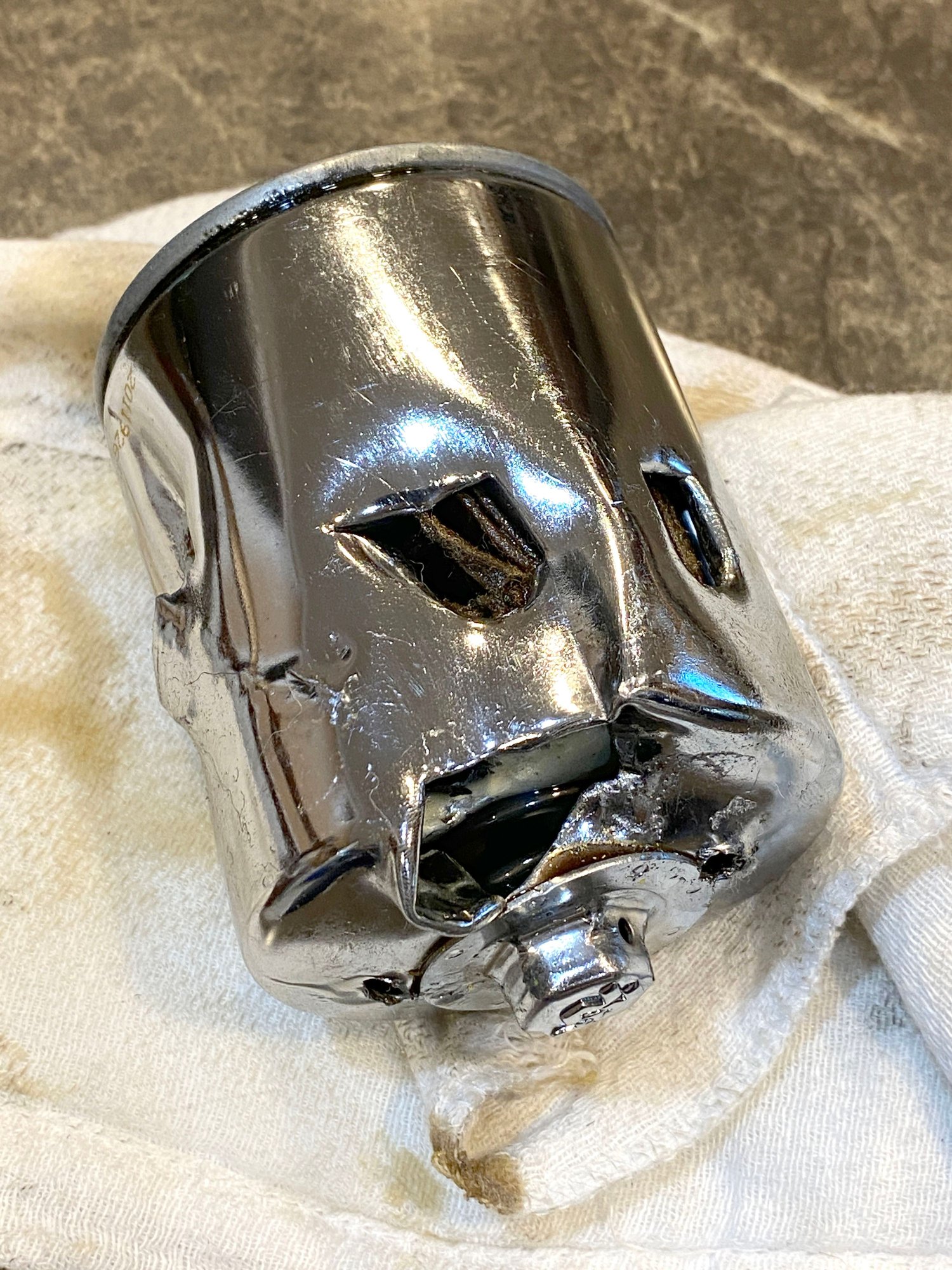

Originally Posted by flh canuck
If you are using the socket style oil filter wrench and it spins on the end of the filter, place a shop towel over the face of the socket and force it onto the filter. Usually that will prevent it from slipping on a too tight filter. If that doesn't work, time for plan B. Nothing more annoying that dealing with an oil filter that was previously installed by a Gorilla....
I've had to get creative and improvise like that before, then used a 1/2" > 3/8" adapter to get the stouter extension and handle and pushed with all my might, when it started turning I knew I was home free

Stab into side of filter with screwdriver, then you can push down to start unscrewing it. It has worked for me before.

I bought the oil filter wrench and started to loosen it up the bike started moving, then I put in gear and started to give it some torque to loosen up and I was concerned of it skipping around the filter but all good. Got her going , worse part is I put the filter on and I know that I did not gorilla it on there. Not my first rodeo but scary cause of the limited access space not like my 98 dyna. Thanks again for updates what to do
Been there, done that.......
