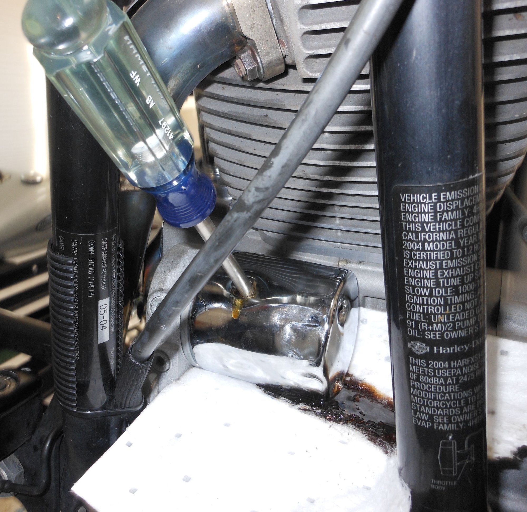

Originally Posted by bulldog1776
Stab into side of filter with screwdriver, then you can push down to start unscrewing it. It has worked for me before.
I had a filter wrench like OPs, and on a friend's bike it broke the welds trying to get his filter off. I don't know who/how it was put on before, but it was a mother.
I had to drive a large screwdriver through the filter to get it to start to turn. That was after a strap wrench started collapsing the filter, and the old, "screw through the filter wrench into the filter" trick also broke another cap style filter.....

Making a project out of a simple resolve ... The screwdriver not only does the trick but it drains the filter before making a mess
