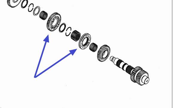

It's very possible that you have a worn down 3rd gear and the dog ring also worn down.
When guys with high horsepower motors strip 3rd gear, it generally is because it won't stay engaged and strips the gear because it slams in and out of gear under power.

Ohio has the answer.. It is the tranny. Need to replace those parts plus the shift fork.. Probably worthwhile to rebuild the whole thing.. Go to a heavier trap door.. Replace the main driver gear bearing. Or install a Baker.
