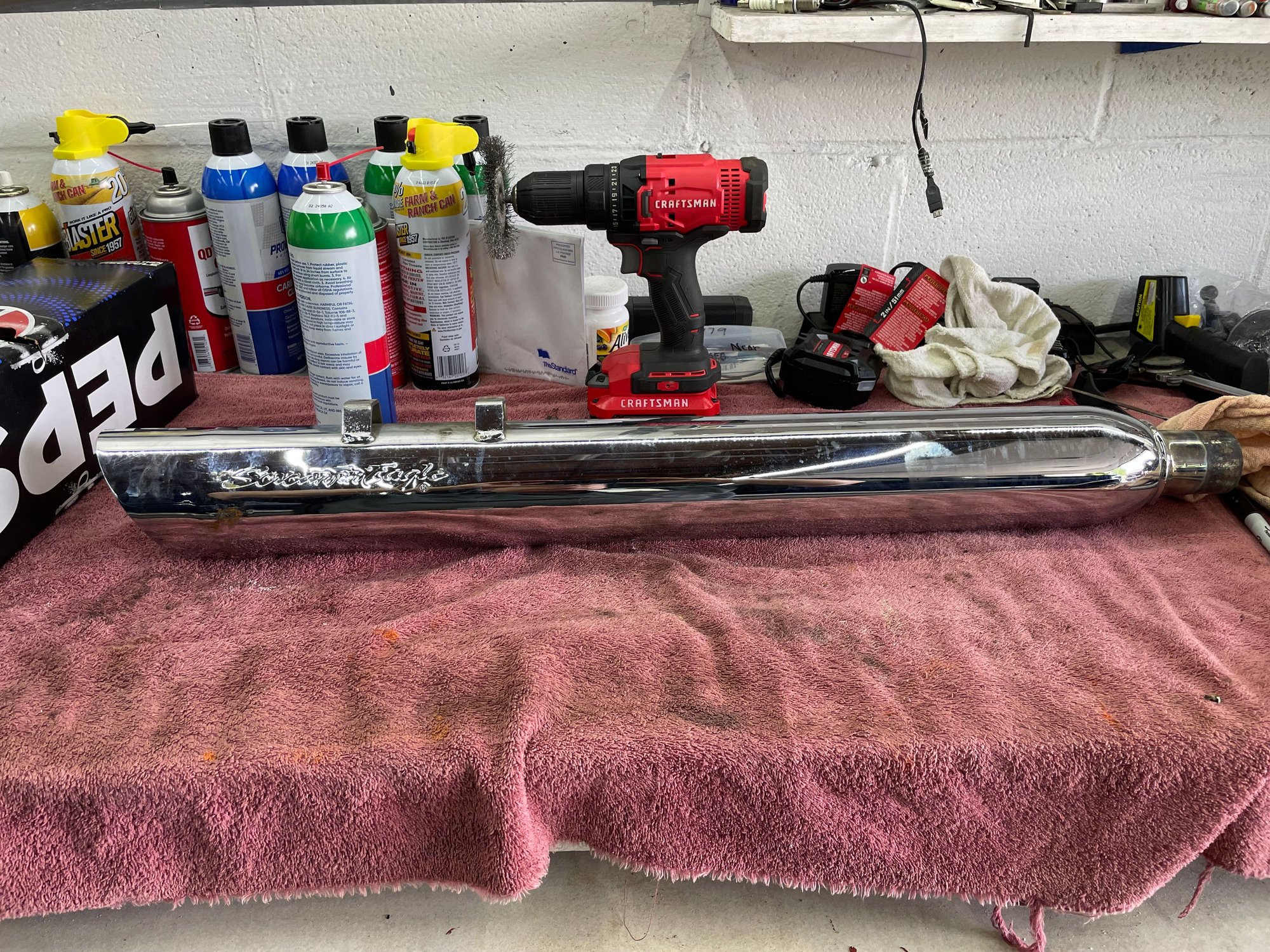

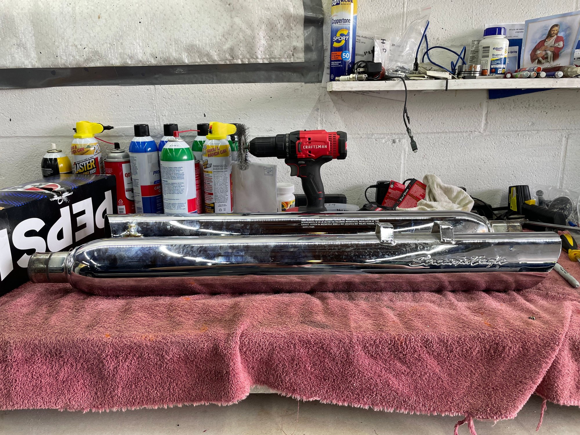

SE Right
SE Right
SE Left
SE Left

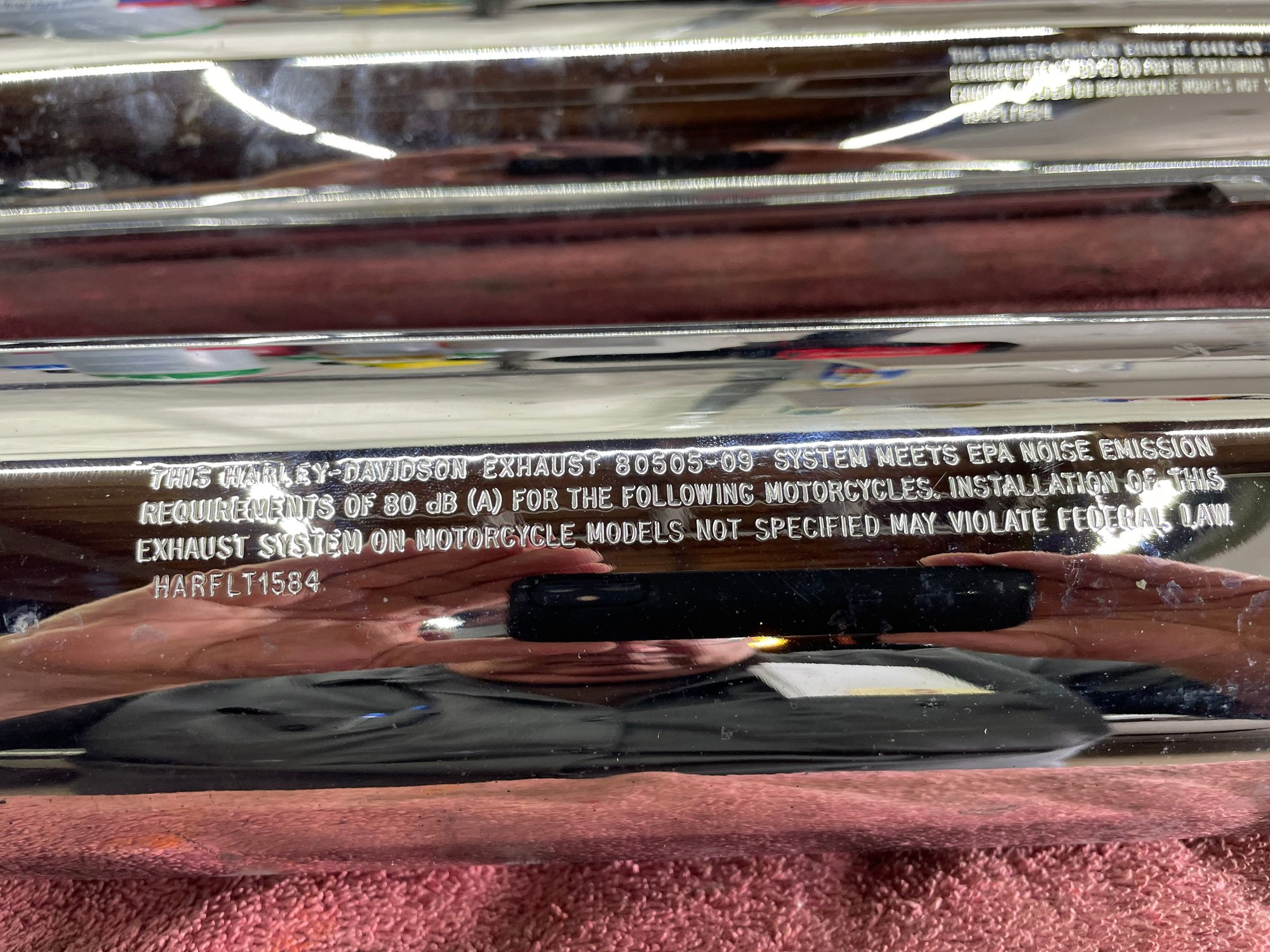

Both pipes have two sets of numbers, on set is the same on both pipes : HARFLT1584
The other set is unique to each side : RT = 80482-09 + LT = 80505-09
I have no clue what each set of numbers mean, or if the numbers you posted will work on your bike .

the HARFLT1584 refers to the bike. the exhaust has been certified for use on harley flt with 1584 cc engines (96 ci)
