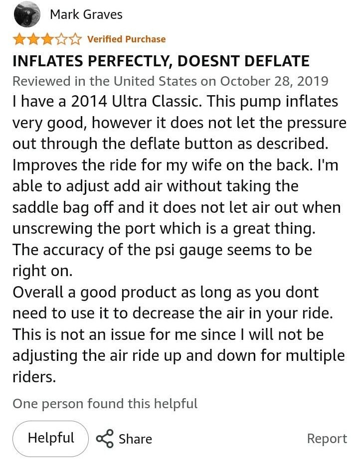

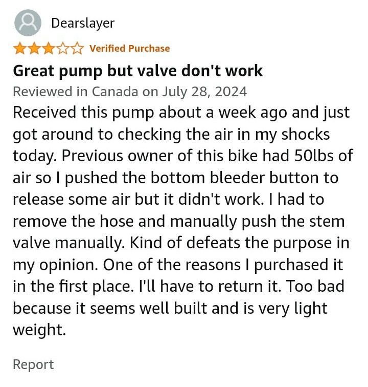

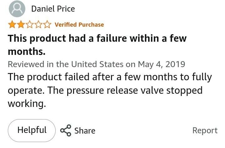

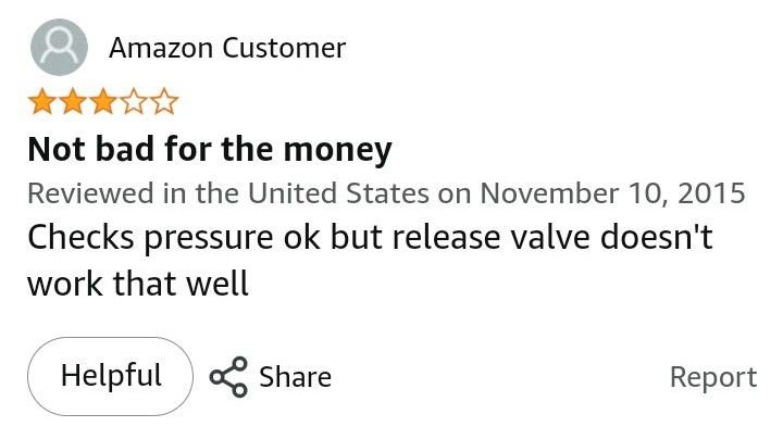

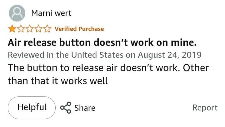

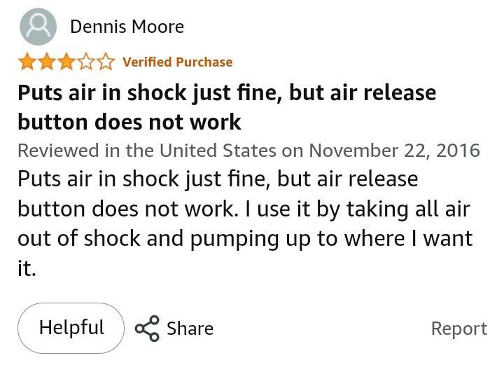

When purchasing items from Amazon, I carefully read all the reviews, both positive and negative. The following reviews would have been a red flag for me.

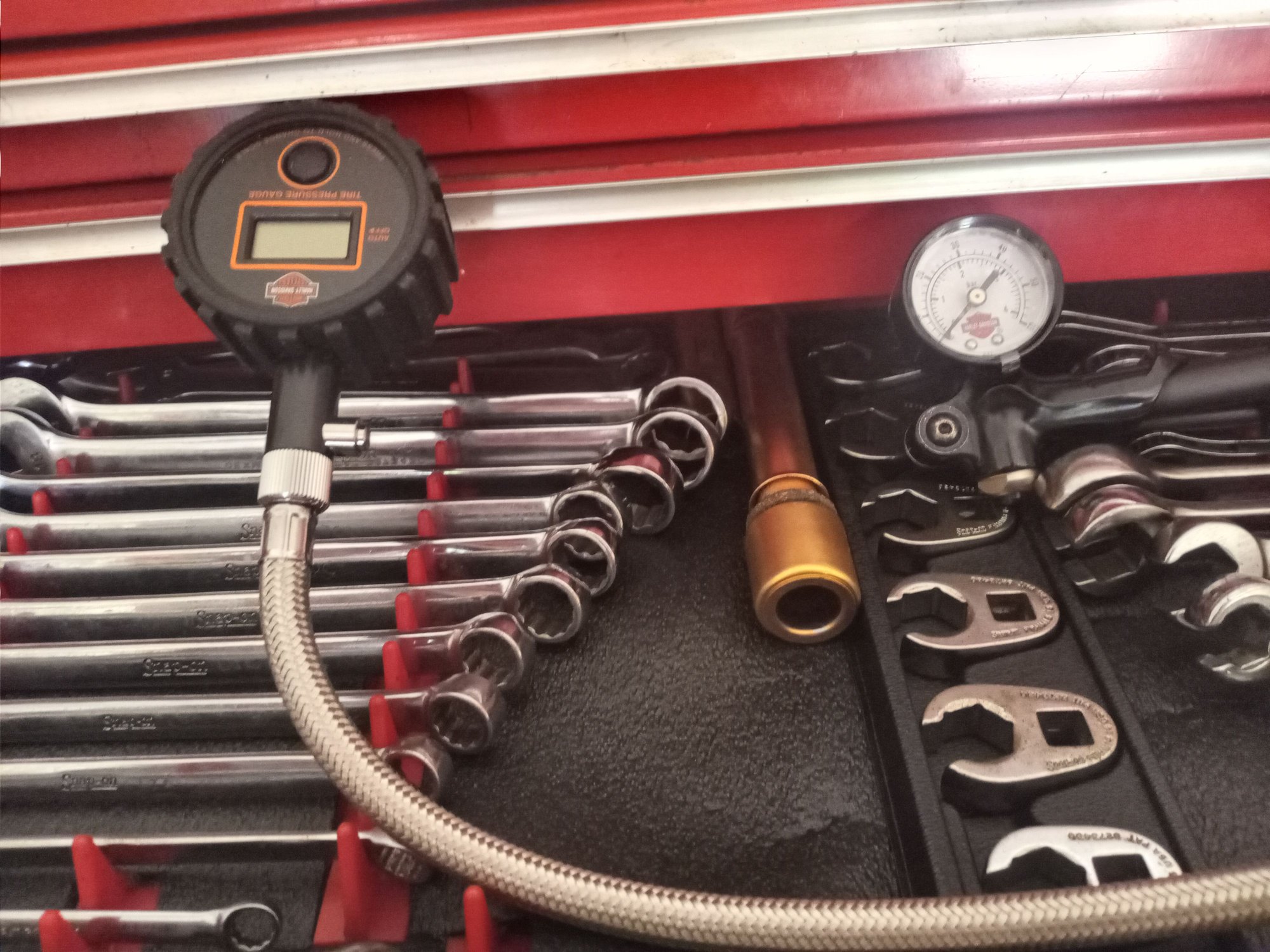

When I got in I tried the pump on both the motorcycle tires and bicycle tires and the bleed button didn't work on either.
