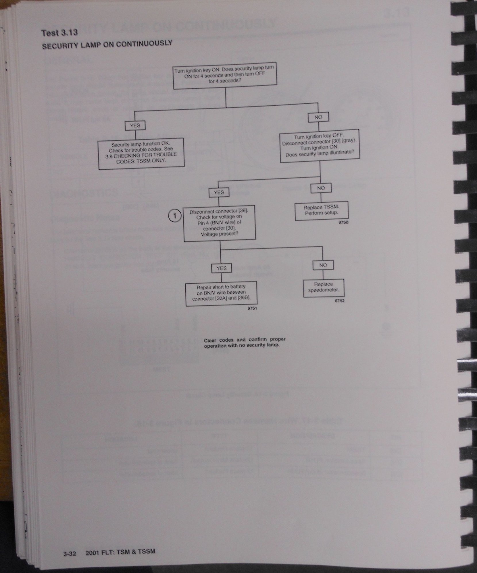

I am no electrical guru, however I can follow the electric diagnostic manuals when I need to, and if I concentrate.
I happen to own the two-volume HD Factory Electrical diagnostic manuals. They are divided into sections for: XLH / DYNA in Volume I, and Softail / FLT / Appendix (electrical connectors) in Volume II.
I will share what I have just looked up in the manual, but may not be able to sufficiently expain the details if you have questions... however I will try.
The 2001 section for Harley FLT (touring) models allow you to check for Speedometer codes, TSM/TSSM codes, or Engine Management codes. You can check all three with a Harley Scanalyzer (dealer's had this tool) or through different manipulations of various switches on the bike.
However, per the 2001 FLT Electrical diagnostic manual and based on your description of the problem, it would appear you have an issue with the TSSM, the Speedometer, or have a wire short to the battery on BN/V wire between connector [30A] and [39B].
I have attached the pages to the explaination of the issue, and the diagnostic process to figure out which of those issues you have..
I hope this helps...
