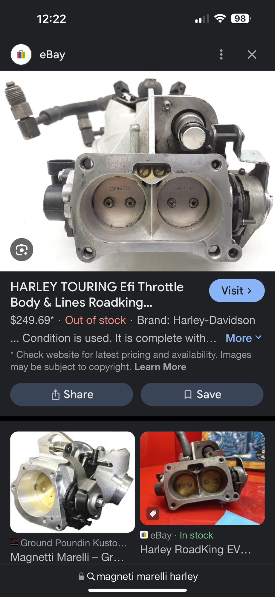

Hey guys I have a 2001 road king classic, my question is the 2 “idle air speed or pilot screws” on the throttle body, are they the same as a carburetor pilot screw, in for lean and out for rich? My bike has aftermarket slip ons and a k&n style air filter, it has popping on deceleration like a lean pop, any info appreciated!

I have worked on Webber/Masrelli EFI systems on another brand bike, but not one on a HD. To try to answer your question.....On the Webber/Marelli system the screws that I believe your referring to would be Air Bleed Screws. The screws open a passage to allow more air in past the butterfly. Screwed in and the air bypass is closed. As you unscrew them, it adds more air.
Again, taking a guess here based on another Marelli system. Hope it helps,
Tom

Short bus is someone change air bleed port screws, start with hot and cold idle set via voltages, ecm reset for tps, remove vacuum cap port plug and put vacuum gauge on port, then let IAC control the idle to hold the rpms to 1K with motor warmed up,and adjust port screws evenly to each other, while trying to get the highest vacuum number at 1K rpm. As for screws if someone tampered with them, start about 2 turns out and normal turns would be about 2-1/2 turns out/highest vacuum number at port with motor at 1K with motor hot and IAC control.
Rubber cap plug on vacuum port,and make sure your rubber plug off cap is not cracked to cause air leak, or someone forget to reinstall it and why your having problems with IAC not controlling idle correctly with too much air flow past the vanes, with everything else set correctly.
