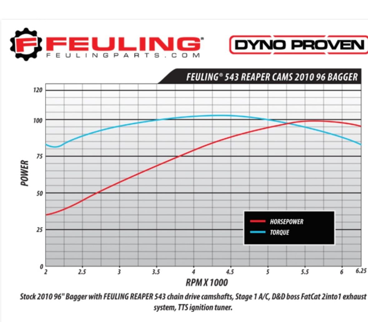

I'm looking at the Woods 777 or the Feuling 543. My SG is mostly used for solo/ 2up freeway driving. I want the torque between 3-4500 rpm, but I'm all ears if you have any suggestions.

The cams you’re looking at would be more at home in a 103 or more compression. The Andrew’s 48 or something similar might be a better option. The cfr’s aren’t known for torque either.

Really? I looked at the Feuling's site dyno sheet for the 543. As for the Woods, I made a mistake. I meant the 555, not the 777. Both were done on the 96".
My Indy guy recommended an Andrews cam, but I can't really find any dyno sheets for many those cams on a 96". Do you know of any?
As for the CFR's, I know. I've heard so much about tuning the low end. Problem is I love the sound.
