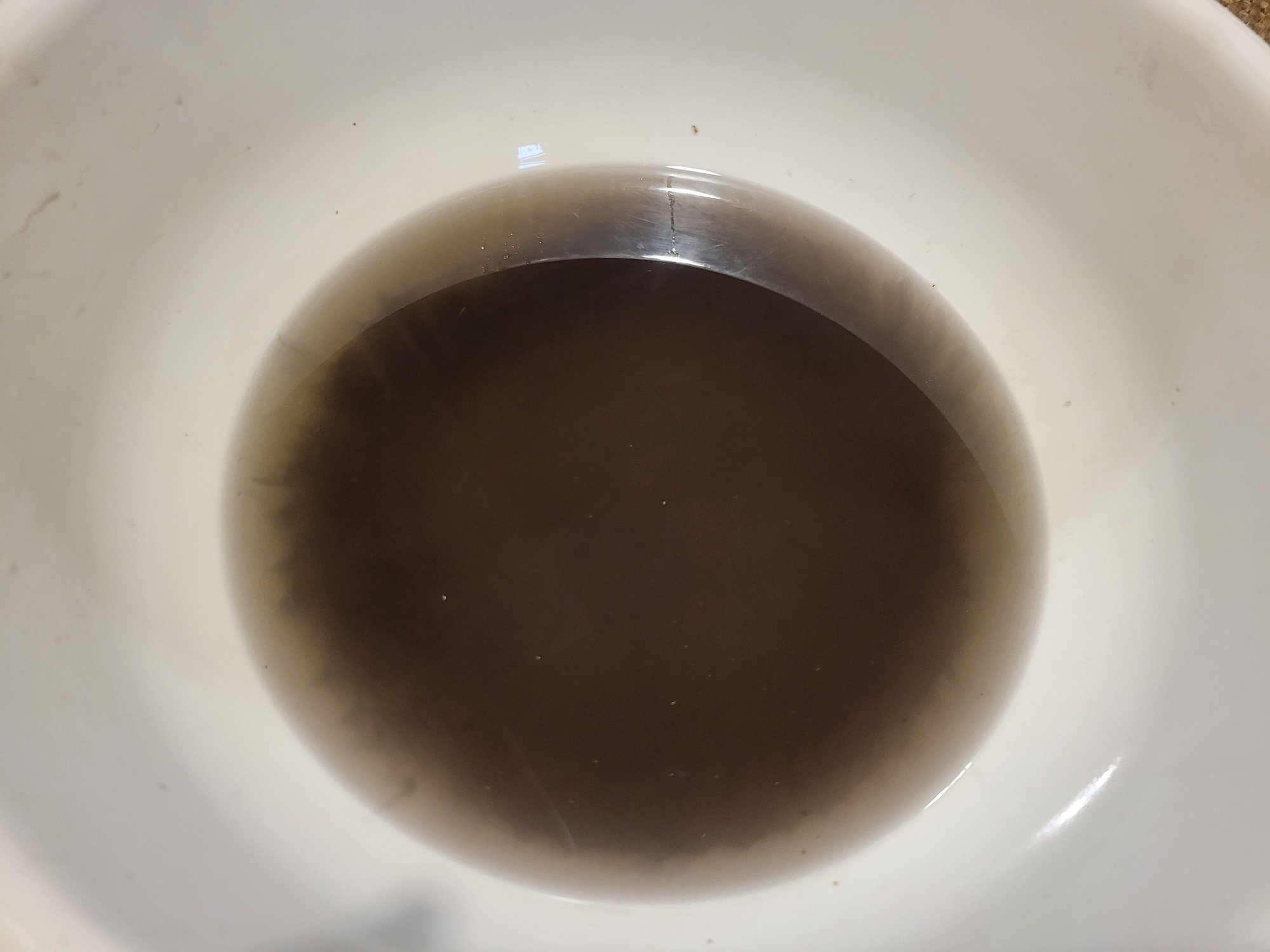

Here's a pic of the oil only after something like 600 miles. Legend setup takes less oil but this is literally what came out of both tubes:

Color of the used fluid, really comes down to the color of the bushing teflon coating in the end.
Being that the used fluid in your case is more of a bronze, then that means that the Tefon coating on those bushing are more of a bronze color, then black coating color instead.
And to point out, cartridges that use less fluid, but still have Teflon bushing, just means that less fluid that the coating as it wears, is going to saturate faster, meaning more frequent fluid changes, and in cartridge systems, ones that you can not service yourself.

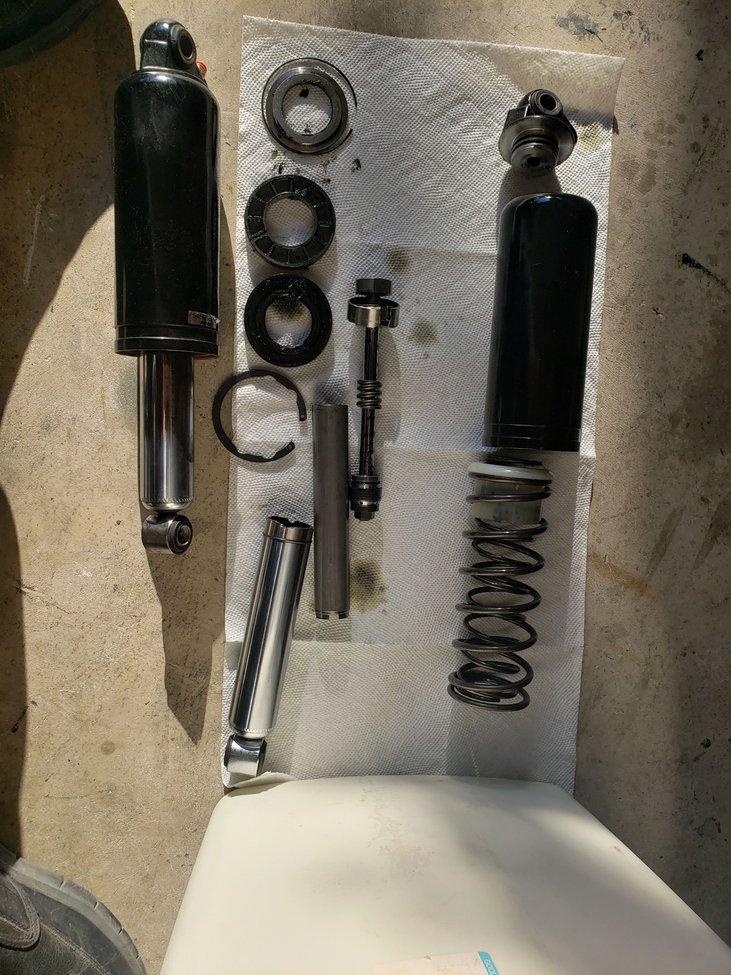

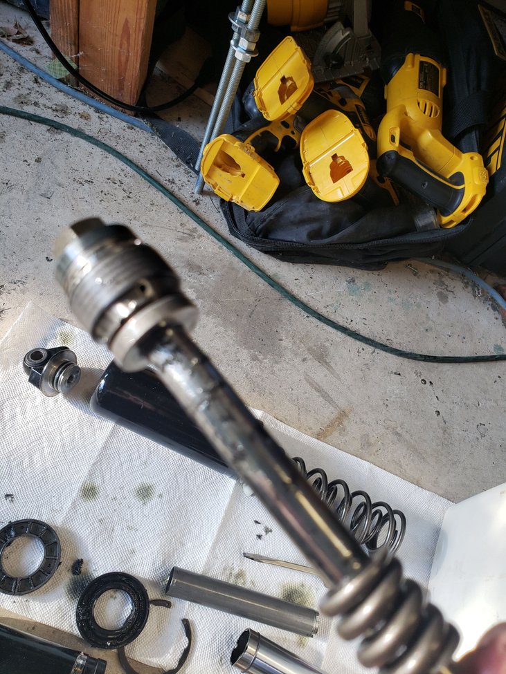

As for rear air ride shocks,the world is your oyster to adjust the dampening over just fluid weight changes, since dampening wave washer stack is just too easy to adjust for a few dollars as well.
Note, in the above dampen stack, rubber bumper on shaft started to dissolve, to make the dampening too stiff due to the rubber blocking the passages ways. So nothing needed more than just unbolting the nut, to pull the stack one by one to spray clean with carb cleaner, then reassembly the stack and retighen the rod retainer bolt with some Red loctite.
So if doing fluid changes on the HD air shocks, and you are getting chunkies out with the old fluid, then may be time to pull the shocks apart, and spend the few dollars to just rebuild the shocks, even if they have not started to leak yet.

To add, was this the fluid from the forks outside of cartage void area that is used to keep the oem bushings lubed, or was this the oil from inside the cartridges that is used for dampening and internal cartridges lube?
I ask, since with even switching to cartridges in the forks, you still have to replace the oem fork bushings and seals, plus run the light amount of oil in each leg to keep the oem bushing lubed, and which they still wear at the normal about of wear that they should be replaced every 30K as well.
Simply, after market cartridges may come with life time warrenty, but does not mean they will not still need to be rebuilt/fluid changes from time to time, as well the oem bushings and seal and fluid used to keep them lubed, replaced ever 30K like normal a well.
