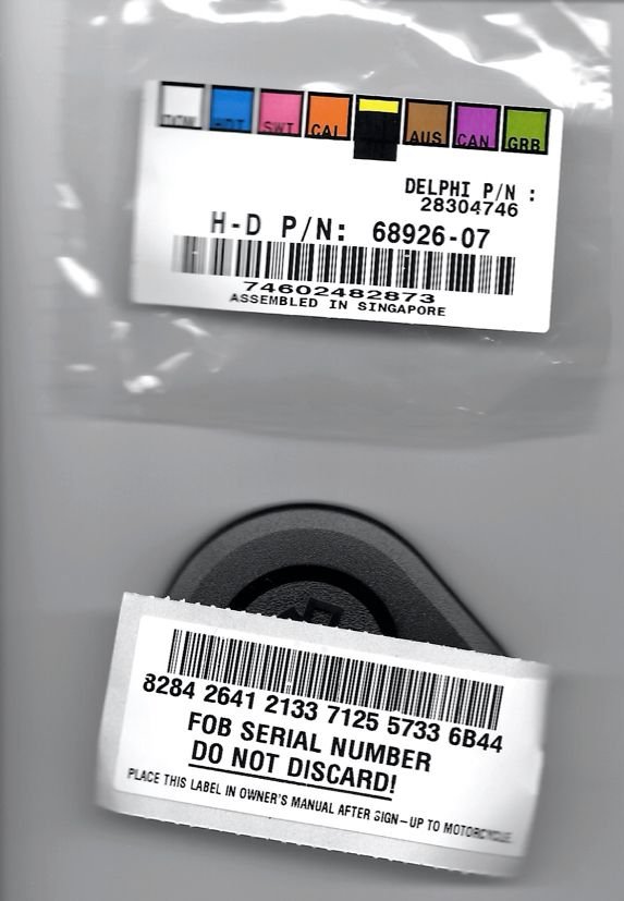

When you buy a FOB, it will have a serial number tag with it. That serial number must be added to the TSSM (older bikes) or BCM (newer bikes) for it to work with the security system.
Each bike can have a max of two FOB serial numbers added to the security.
The FOB can be added/subtracted from the TSSM/BCM via the dealer's Digital Tech 2 computer... OR... if you have friend (or Indy shop) with one of the other diagnostic tools, like the TechnoResearch Centurion Pro or Twin Tech Twin Scan 4, they can do it for you...
