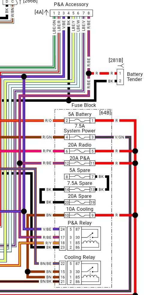

The OP's bike is a 2011. The factory battery tender connector was first introduced on the 2014 models. The factory connector is protected by the 20A P&A fuse.

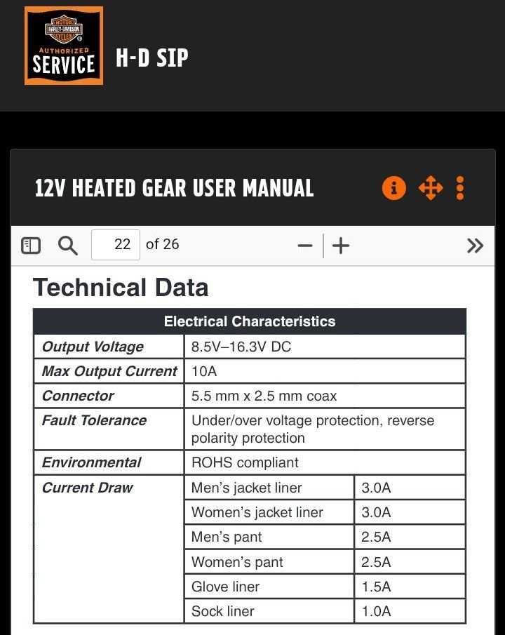

Below is the current draw for HD's heated gear.
If you and your passenger were to wear the above gear combined, it wouldn't exceed 20A.
