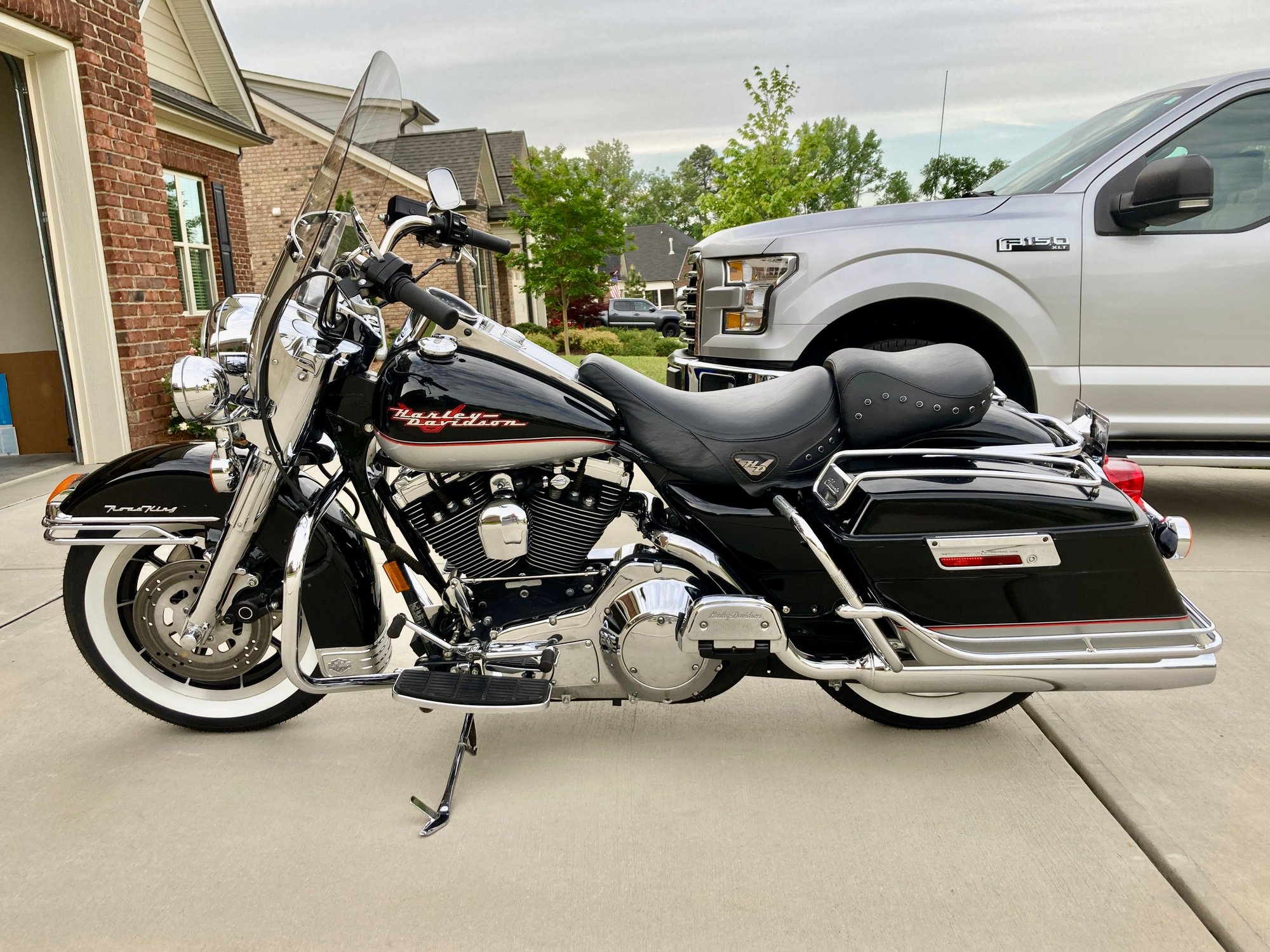

Nice new purty windshield on a ‘95 King. Not my bike anymore. That’s the day I sold it three years ago.
