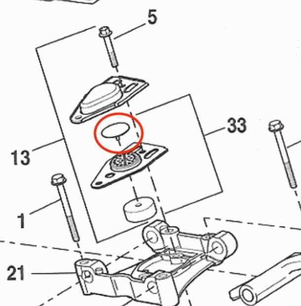

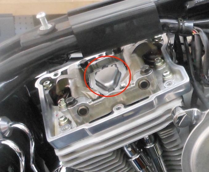

Just to fill in the "why" it happened.....
When you blocked those hoses to the air filter, you were not allowing the Breather Valves in the heads to vent crank case pressure as designed.
Luckily, your fix was just an easy thing. Fix the vent hoses.
For future reference,
If you had those same symptoms, and the hoses are all properly attached and not blocked, that would mean one, or both of the Breather Assemblies in the head malfunctioned. They get blocked when the rubber umbrella valves, for whatever reason, become "stuck" to the assemblies and don't allow venting. To fix those is easy too, but you need to remove the fuel tank and rocker covers to get access.
