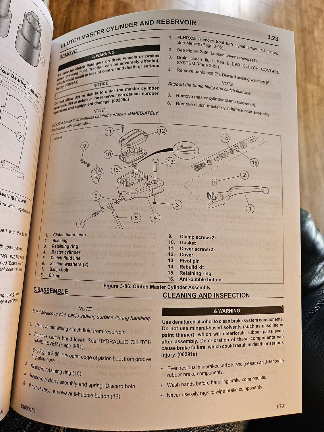

Originally Posted by dprintz427
Thank you my service manual shows a cable type clutch
My 2018 manual shows a hydraulic clutch. From my manual:
