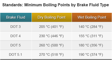

When DOT 5 fluid (silicone based) was introduced in 1972, it was considered an improvement over the DOT 3, DOT 4 (Glycol based) fluids. It had higher wet & dry boiling points, does not absorb water, and does not hurt paint. Because DOT 5 (silicone based) fluid doesn't absorb water like DOT 4 (glycol based) fluids, it usually has a longer service life than DOT 4.
In fact many people with older vehicles and/or vehicles that that will sit for extended amounts of time (vehicle collectors), will often choose to use DOT 5 (silicone based) brake fluids.
The reason DOT 4 (glycol based) fluid is the main fluid used today, is that DOT 5 (silicone based) didn't play well with ABS systems. Basically it forms micro-bubbles when agitated, causing issues with ABS systems. DOT 4 (glycol based) does work well with ABS systems. Harley went back to DOT 4, from DOT 5, when they introduced their ABS system into the model line-up in 2005ish.
DOT 5.1 (glycol based) fluid is a more recent attempt to make a glycol based brake fluid with boiling points comparable, or sometimes better, than DOT 5 (silicone based) fluids.
Now, there are even some high quality DOT 4 (glycol based) brake fluids with really high wet & dry boiling points, like Motul 660 or Motul 700.
But because DOT 4, or any other glycol based brake fluid is "hygroscopic" (meaning it readily absorbs water), the DOT 4 family (glycol based) of brake fluids will generally need to to be flushed sooner, and their wet & dry boiling points will degrade sooner than DOT 5 (silicone based) fluids.
