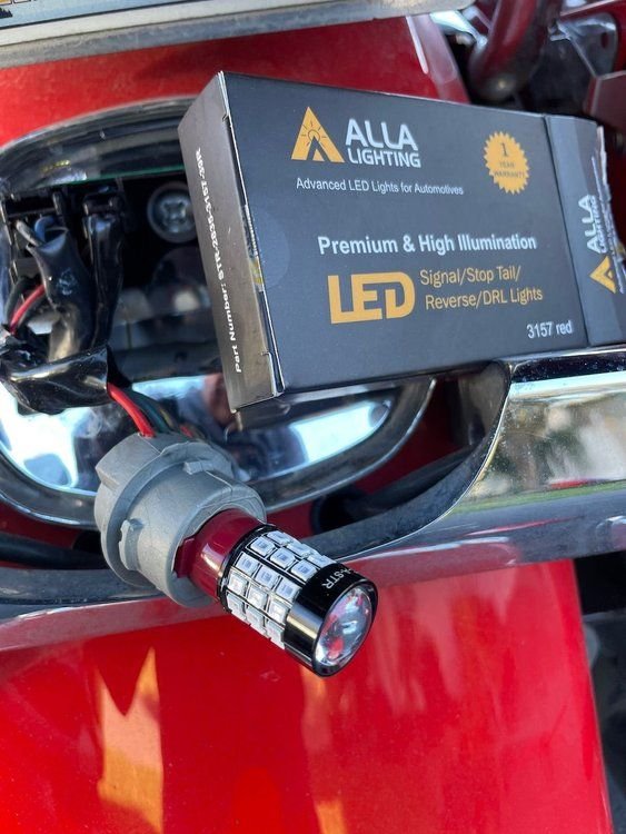

FWIW - I replaced the brake light bulb with a flashing bulb on both my 2010 FLHTK and ‘42 WLA. Way cheaper than the whole CD set up. They are all over Amazon. Both for the old school 1156 & 57 bulbs and the newer style one. They have internal circuitry to make them flash.
For my 2010 FLHTK. Two to a pack.
