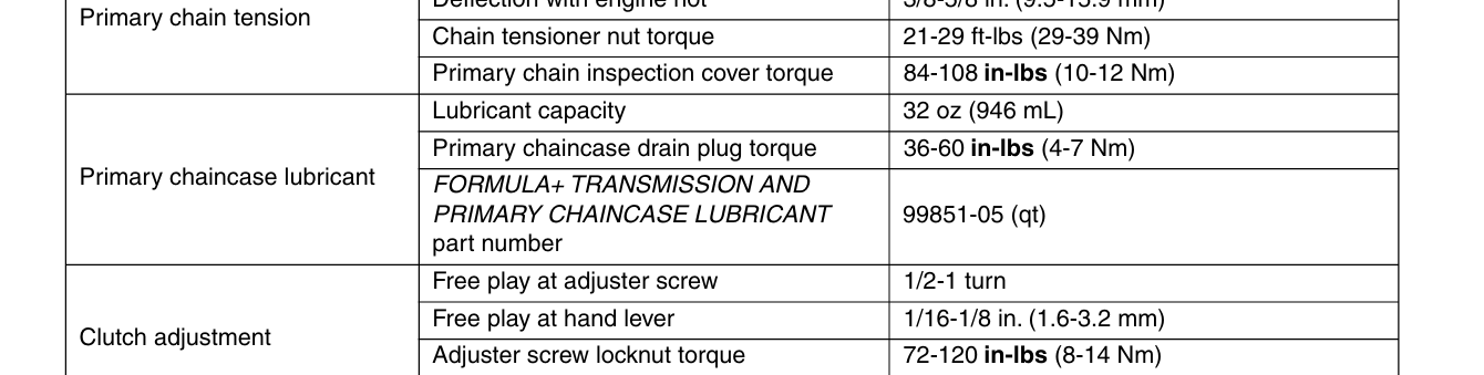

From the 2006 service manual.

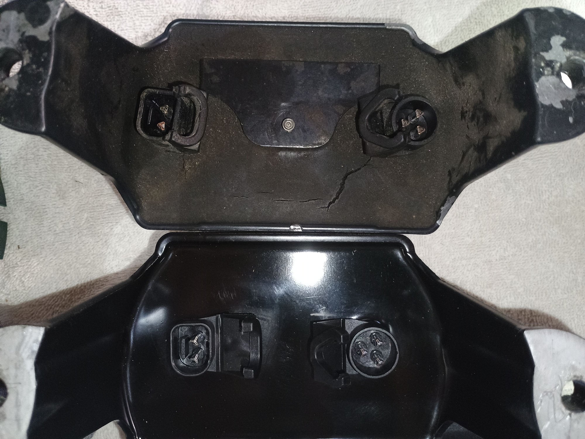

So after all that and having it back together I put the voltage regulator on and the plugs on the back of the voltage regulator I too close together to run the wires underneath there. They chafe in just a few rides from what I can tell. Now I'm going to order a different one that isn't on Amazon and see if that sets up better. It doesn't look like much in the picture but it definitely is tight enough so I don't dare to use the new one. Any recommendations?

Old Jun 21, 2025 | 04:19 PM
  #173
Vernal's Avatar
Vernal
Joined: Apr 2013
Posts: 7,684
Likes: 8,423
From: Utah
Like Hat posted earlier, OEM Or Cycle Electric Inc.

I would not own a harley without manual. For older bikes you can find them on ebay. Other year I went and bought parts and electrical cheap. Unused. Though I tend to use online parts, rather than manual.
You need to be careful about capacities and reading forums, I have three TCs and each one has different capacity for tranny and primary.

Update:
Both the cycle electric stator and VR are installed. Took a short ride and all seems ok so far. Need to do a longer ride to be sure.
