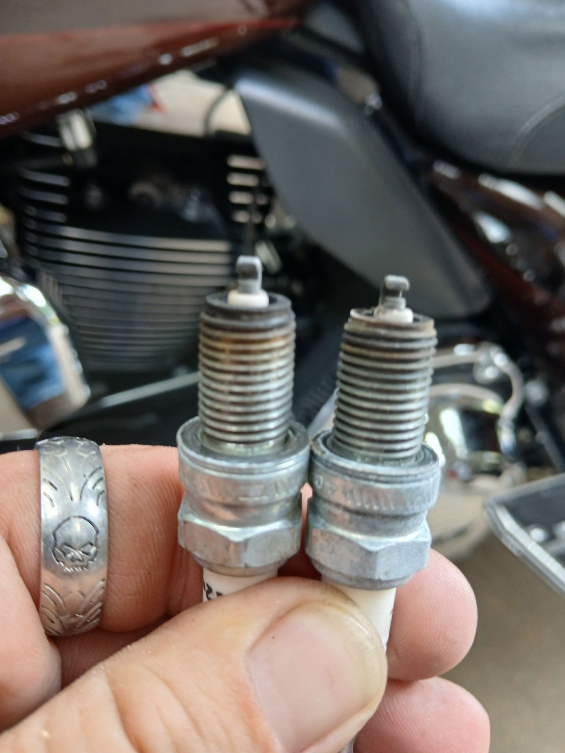

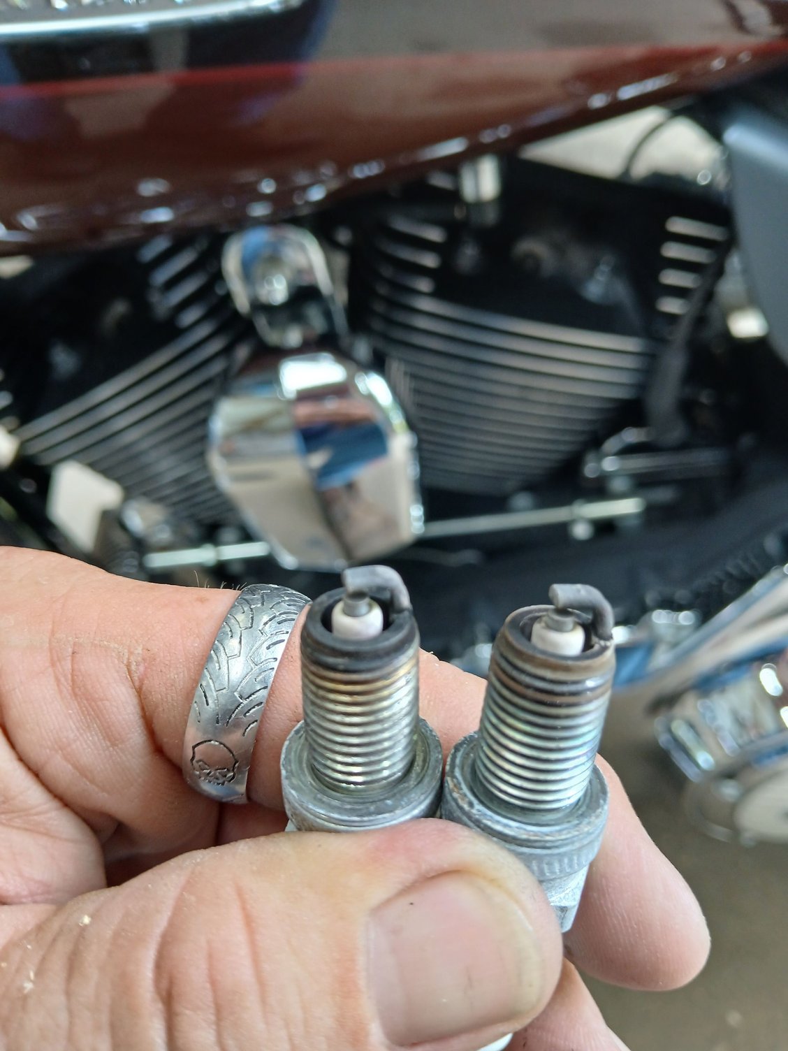

I checked a couple of things that yall have discussed. Like the plugs.
Rigjt sife is front cylinder and left is back cylinder
and the plug wire is rubbing but its not rubbed threw.

Plugs look okay.
Gotta check those plug wires, do you have a meter and know how to use it?
Want to check continuity, connect both ends and wrangle the wires around to see if the resistance changes. If they do, thats a bad wire.
