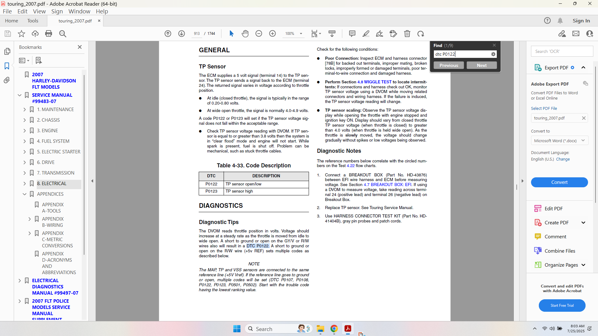

OP, How many miles on the bike?
Check the TPS sensor on the throttle body first.
How old is the battery?
Charge it if you can and then take it to a local auto parts dealer and have it load tested.
Seen some STRANGE things happen with a weak battery.

TPS check was good
I wasn't there when my friend replaced the pump and filters . I've seen some others say it could be the pressure regulator leaking or hose after regulator.
That's my next check
Thoughts
How much gas is in the tank?
If it's low you should NOT hear any fuel spraying in the tank when you turn on the ignition and hear the fuel pump prime.(You can also use a flashlight and SEE if there is any fuel spraying)
The spray wont happen with a full tank as it's covered in the fuel, only shows when the level is low and below the bulk of the fuel system.
If you DO hear some fuel spraying, then I'd day there is a leak in there.
I doubt that's the case as installing those new parts pretty much insures they are tight, IF he did replace everything in the tank, Filter, Regulator, screen and hoses.
Its bit of pain getting the whole system out and back in as it has to be folded INSIDE the tank to do that.
