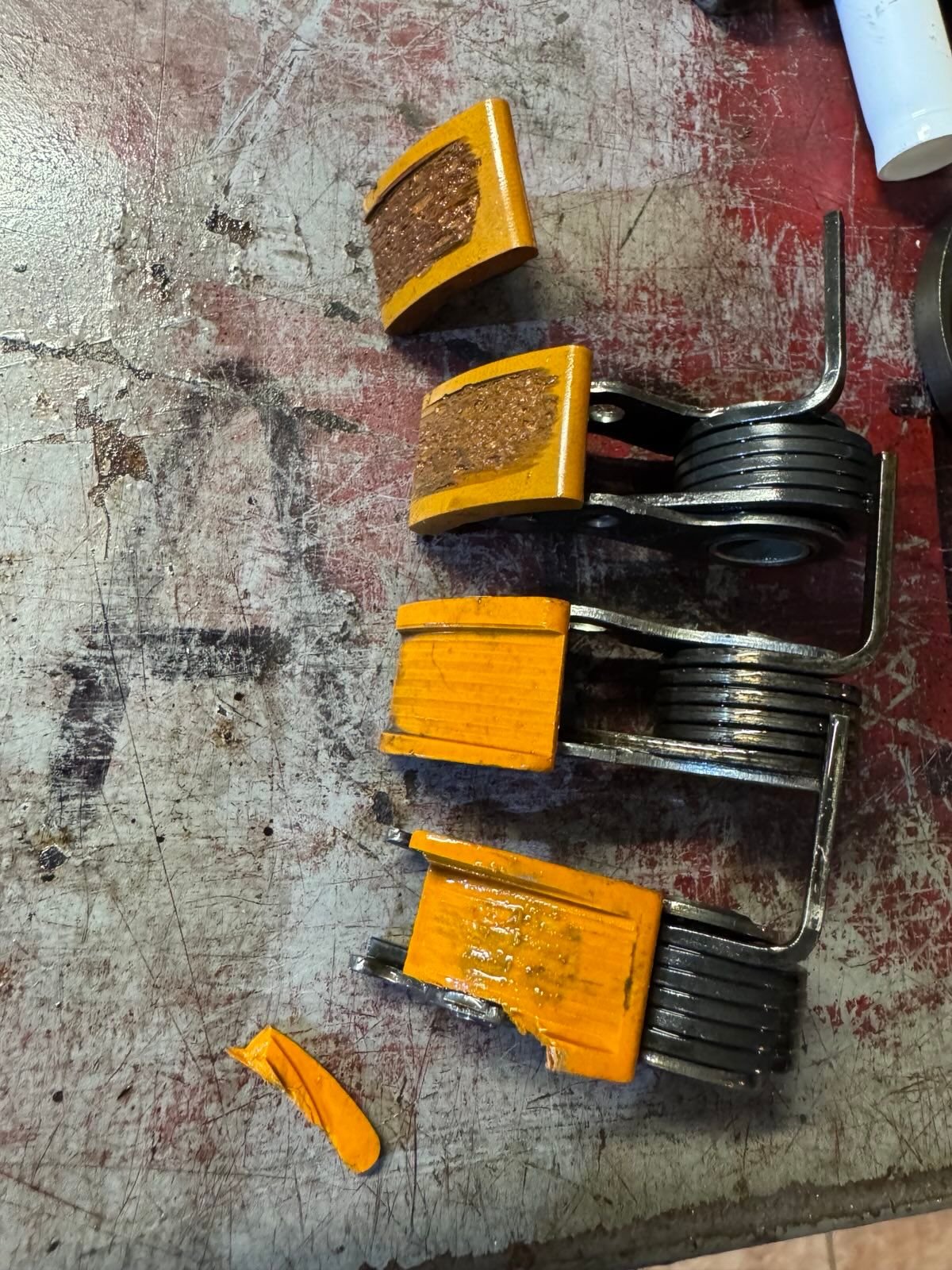

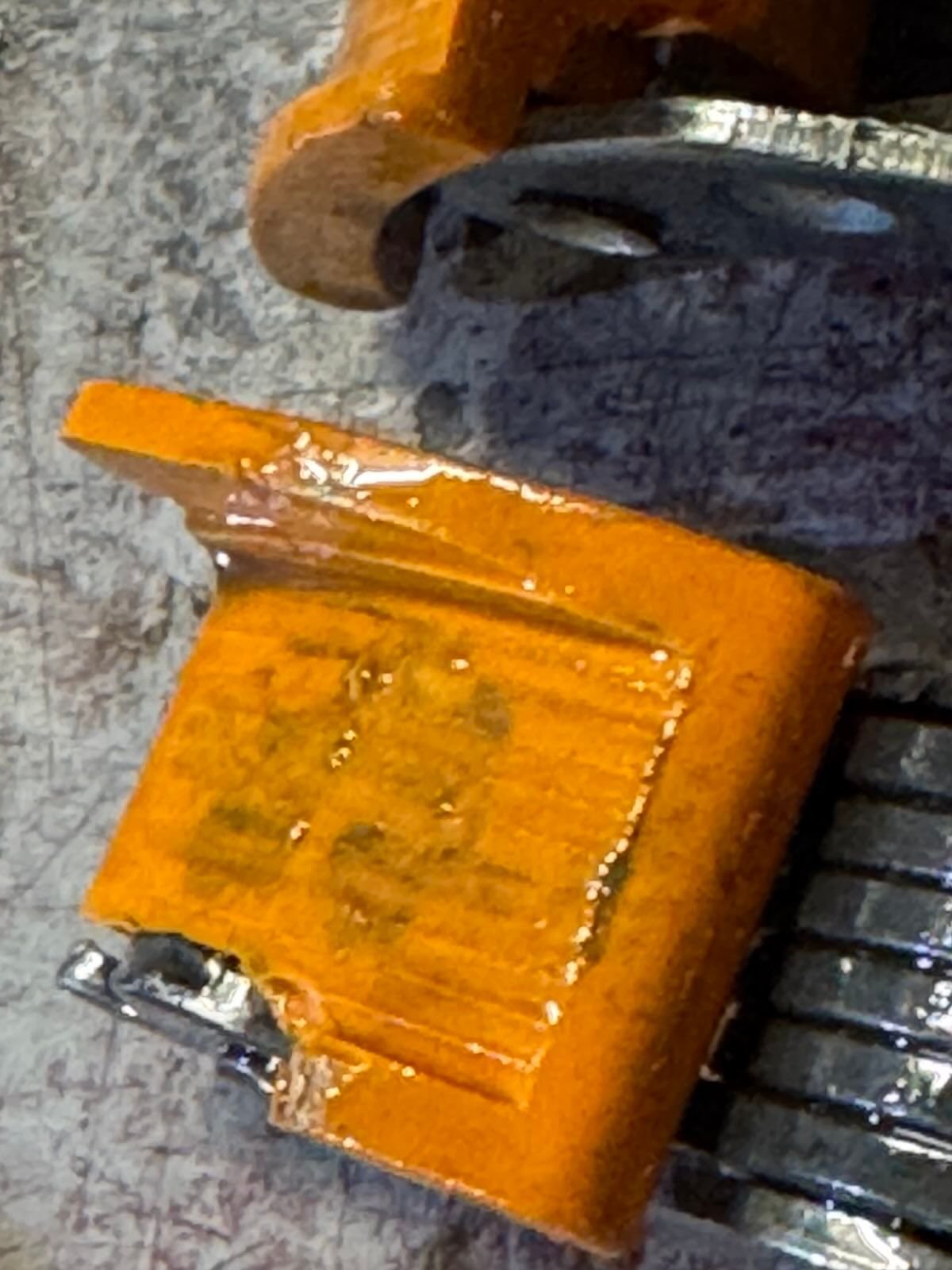

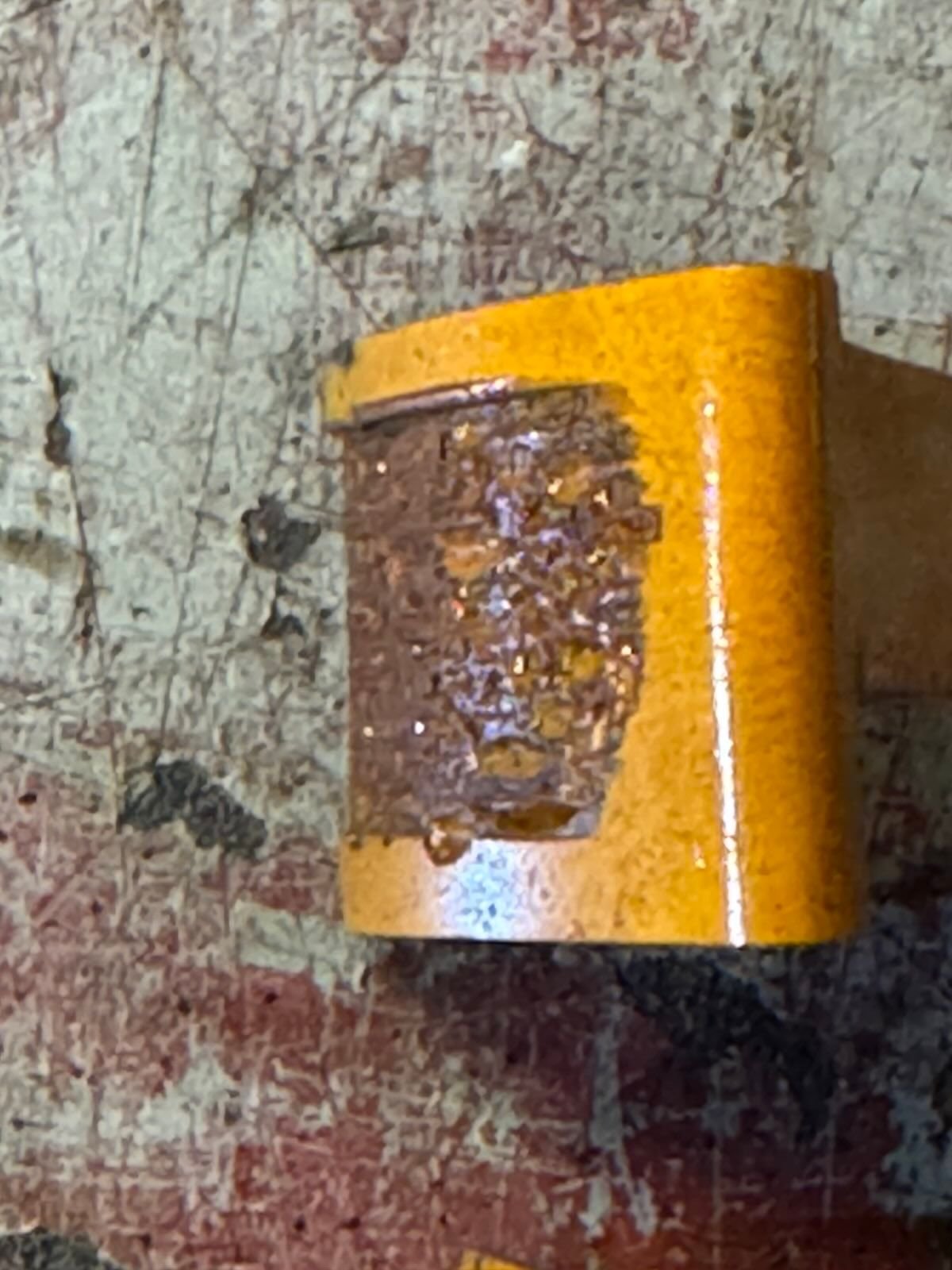

A short intermediate report even before everything is out of the bike. Opened her up and while removing the oil pump chain I had a casual look at the front tensioner pad. It was already worn by about 2 mm deep and this is only after 2500 km.
Called my dealer for new ones and unfortunately they are not in stock and need to be ordered. Drag Specialities will take a week.
So I forgot where these tensioners came from since I had bought them a long time ago but honestly they are very likely unbranded **** from eBay or Amazon. Needless to say I should not have used them, but wisdom comes last, as usual. I have stopped buying Harley parts online for exactly this reason, so fair to say I really should have known better before I did this job. I read in another thread here that somebody had a similar issue with his M8 tensioners he bought online. Unfortunately for him it ended in disaster, so I am happy I had this valve train noise that made me open her up again. Without that I would have suffered the same fate I reckon.
Now I will continue to strip her down and to see if I find other stupid stuff. But once that is completed I will be without wheels for at least one week. Not happy I am!

Angry 2 weeks out of action
Ordered new parts from HD and now have to wait, they are not in stock.
Found two lifters the wrong way around from original, my bad. But overall I am glad I took it to bits again because another 2500 km it would probably have failed catastrofically.
original probably more then 50k km
new with only 2500km
new with only 2500 km
what a difference

Those new tensioner pads are certainly subpar.....
Make sure you account for all the debris from the one that actually broke apart. If debris was to block an oil passage, that could wreak havoc...
