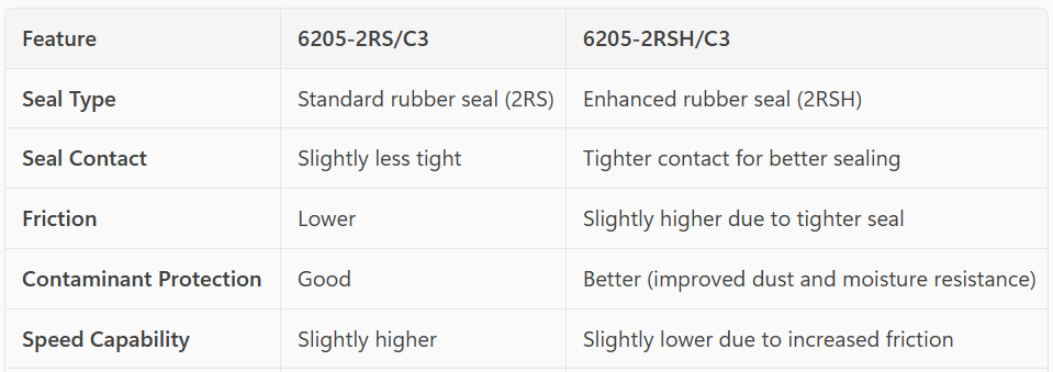

The last set of wheel bearings I purchased at the local bearing supply house were labeled:
SKF Explorer
6205-2RSH/C3
What does the "H" mean? Is this bearing different/better than the 6205-2RS/C3?

The "H" designates an 'enhanced seal', meaning it has a tighter contact. This will increase friction (and heat) and reduce speed capability but improve protection. I would not be concerned with your choice, the difference is negligible in this application. The improved protection surely outweighs the cons.
