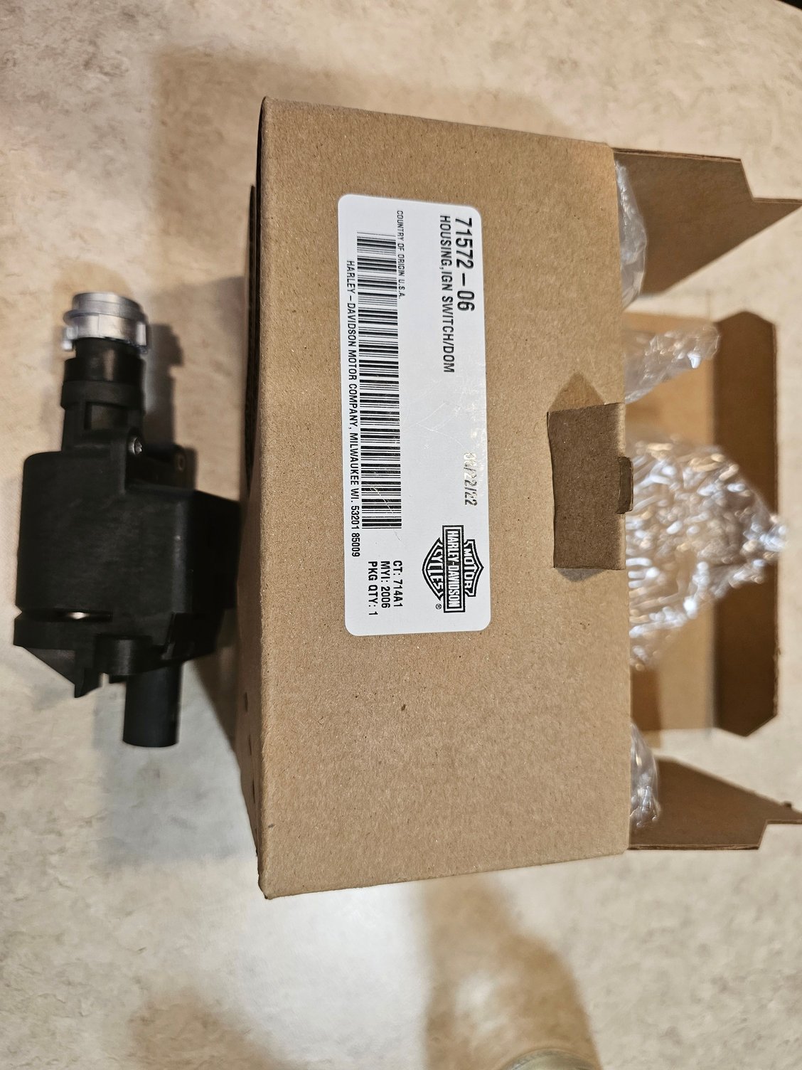

Originally Posted by MURPHCC1
So you're replacing the ignition switch housing?
Thats the brunt smelling part?
Yes
Does it smelled burnt in the plug?
Any signs of heat or burn damage or anything like that?
What plug is that from?
The plug in the picture plugs into back of ignition switch.

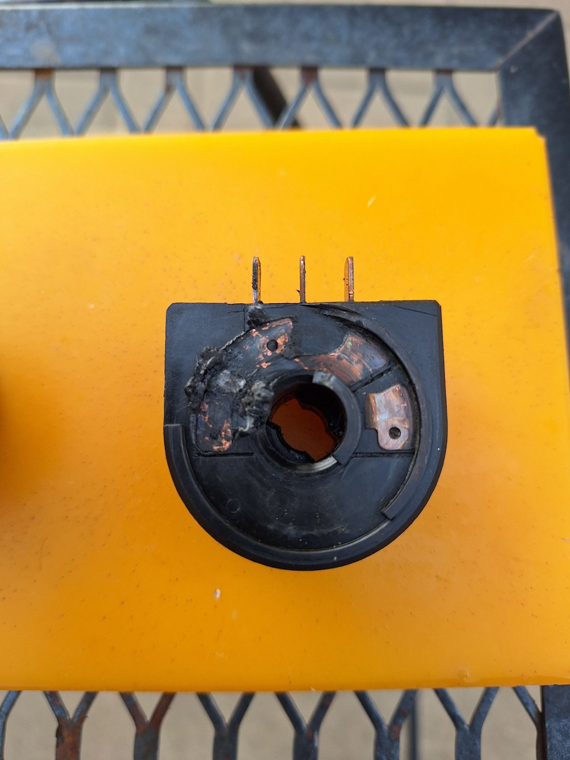

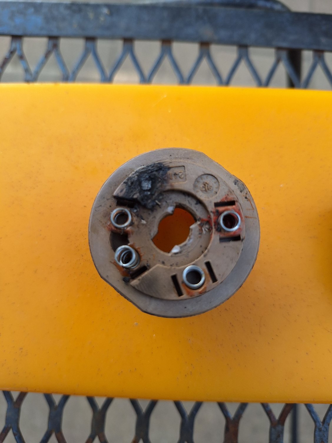

Originally Posted by buell95
Pulled the ignition today no burnt wires or anything. But looking down into it looks like
a couple springs and look like one messed up.
Now just a waiting game for a new one.
Of course local dealer didn't have one.
It is part #71572-06
They are on eBay used, they show still available from a dealer, but not online (maybe backordered), and there are even repop versions available on Amazon....
I would just have to take that ignition apart and check out the insides....
Not sure I could sleep until I did...
You just need some security torx bits... You know you want to...
In nay case, it would appear you found the issue, good luck on the repair...
I bought two new oem ones off ebay already since i have two bikes never no.
I don't have the torxs but I have left hand drill bits.
Both dealers near me do not have them in stock
And would have to order, No telling how long that would take.
Definitely a short of some kind.
Yup!
I'd say you found the problem!
