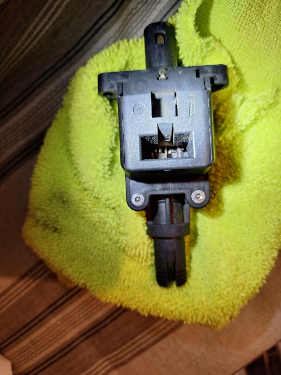

Pulled the ignition today no burnt wires or anything. But looking down into it looks like
a couple springs and look like one messed up.
Now just a waiting game for a new one.
Of course local dealer didn't have one.

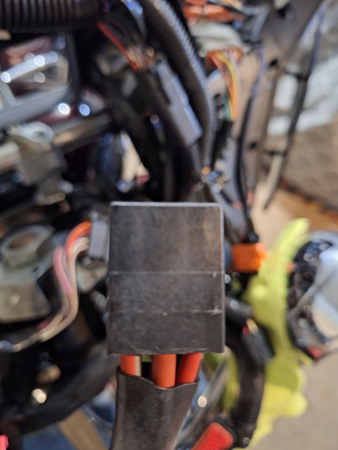

Does it smelled burnt in the plug?
Any signs of heat or burn damage or anything like that?
What plug is that from?

Yes the ignition it self smells burnt.
Connector looks fine.
No signs of any burnt wires or connections.
No wires rubbed through or anything.
