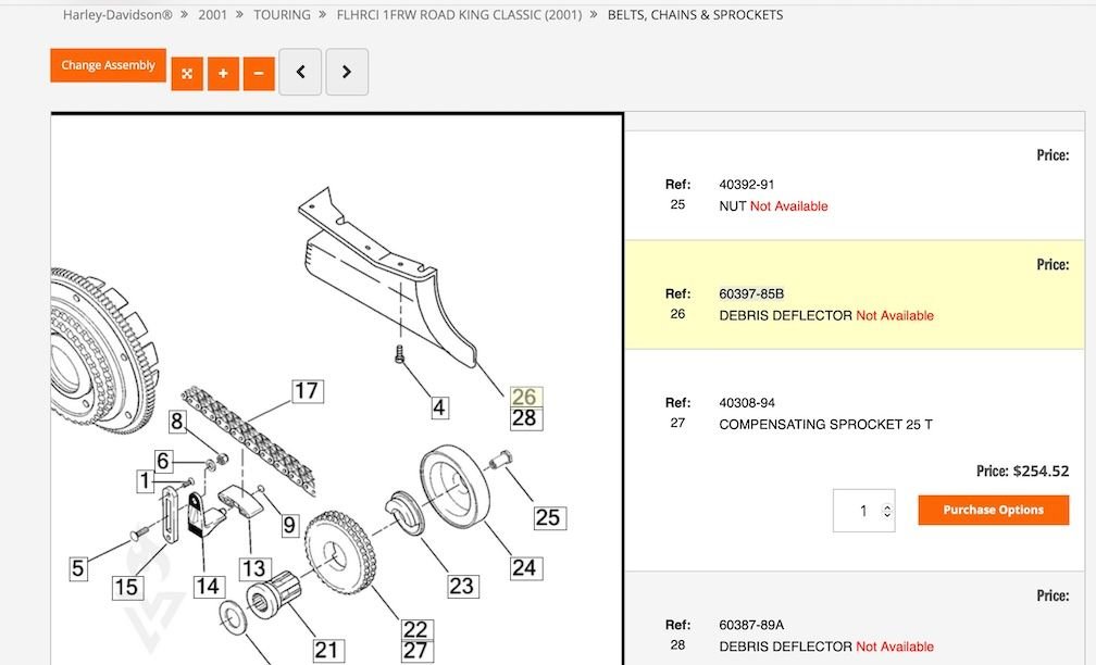

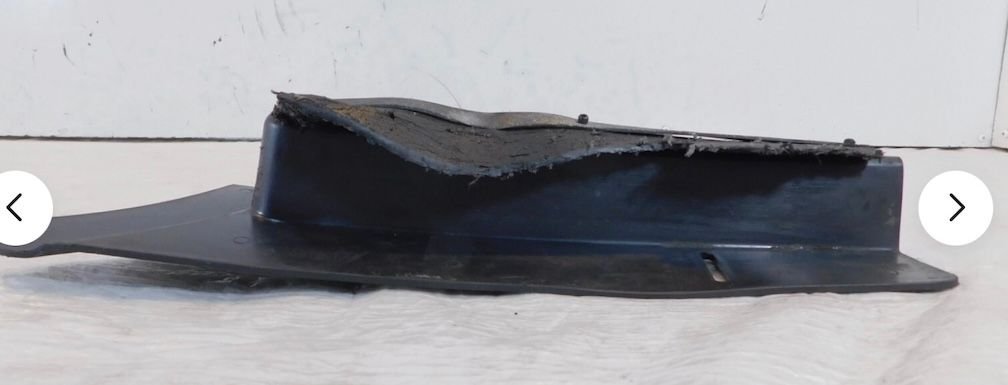

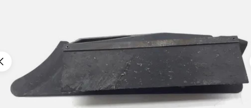

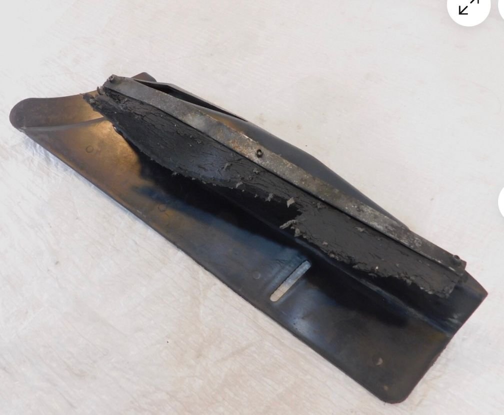

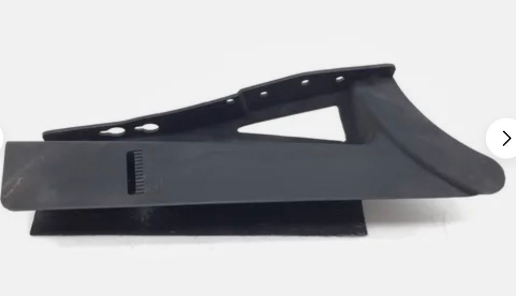

Just in case you haven't removed the lower belt guard yet, it's part #60397-85B. It's a discontinued part by Harley. Here are some pics of what it looks like both undamaged and damaged.
If you search "Harley #60397-85" on eBay, you will find several affordable, undamaged lower belt guards. One for $19.95.
Good luck with the repair...
