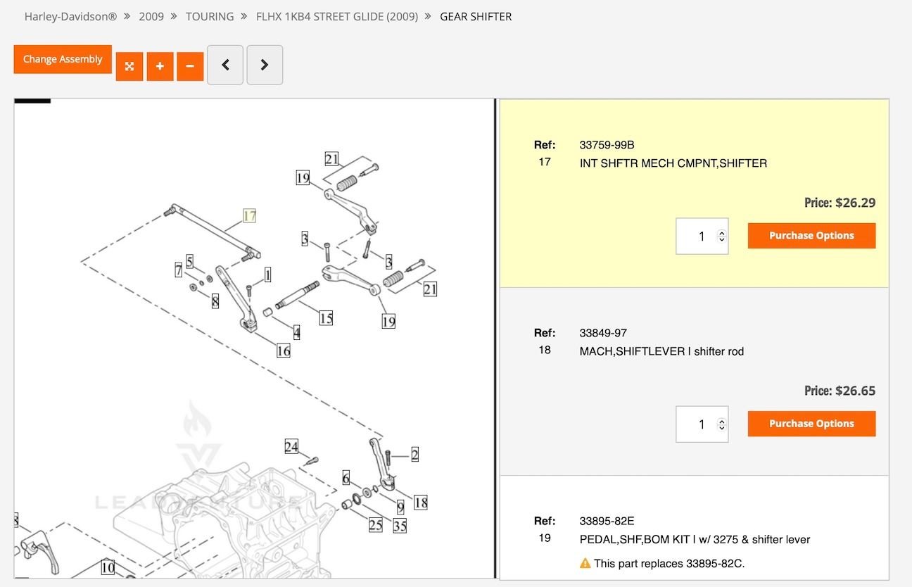

Even though I'm not versed in Harley mechanics, I'm very good when it comes to cages, UTVs, Tractors, Bobcat anything. I'll definitely get a manual. I believe NY issue with neutral is the stock shift rod. It's got some play to it. I usually have to use my hand to find the sweet spot for neutral. Foot just blows by it. No matter how soft i try.
With that background, you will be able to fix just about everything you would normally encounter with a Factory Manual.
Harleys can be quirky, so don't hesitate to ask if you have a question.
For example, if you are talking about slop in the shift rod (#17 in parts pic below) that runs between the foot shift shaft and the transmission shift shaft, it is known to be sloppy with the OEM ball joints. They are also known to fail, usually when you are far from home and/or if you are a "stomper" when it comes to shifting.
Look for an aftermarket shift rod with a heim joint rather than the OEM ball joint. Some people even buy the parts and make their own.
The heim joint will have less wobble and a firmer shift feel. But if any of the other conditions I mentioned above are out of whack, you may still need to "fight" to get neutral.
If you still have the heel/toe shifter on your bike, many find it easier to tap the rear shifter with their heel to get to neutral, rather than lifting with the toe...
Anyways, good luck, and enjoy the new bike!!!
