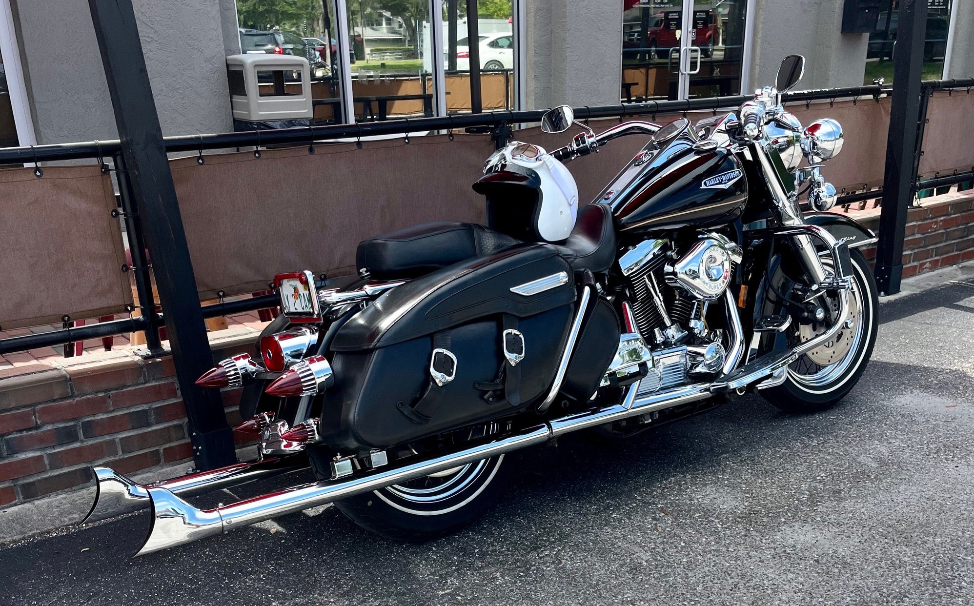

I searched for one for a few months.. found and drove 4 hours to get it. April 12th 2024
Its a 1998 FLHRCI.. had 70,000 miles on it. Paid $4,000. And at the time I didn’t understand anything about them, just knew I didn’t care what mechanical shape it was in. I was after not having to put money aesthetically into it. I wanted carb, Black, NO APE HANGERS. Didn’t care about anything else… didn’t realize it had been converted to carb.
Brought it home and spent three days with buffing wheels and really got the chrome looking good, changed fluids, flushed brakes new pads, adjusted belt, primary chain, just went through it. Rode it 20,000 miles. I rode it really hard.. like lots of 5500 rpm shifts and rode it with sport bikes, really didn’t care about the motor to be honest. It did start to smoke a bit, the last couple weeks I used it, went 50 weight and the smoke was gone… but I’m me. I bought a Ultima 113 out of a chopper that ran but had a blown base gasket for $500.

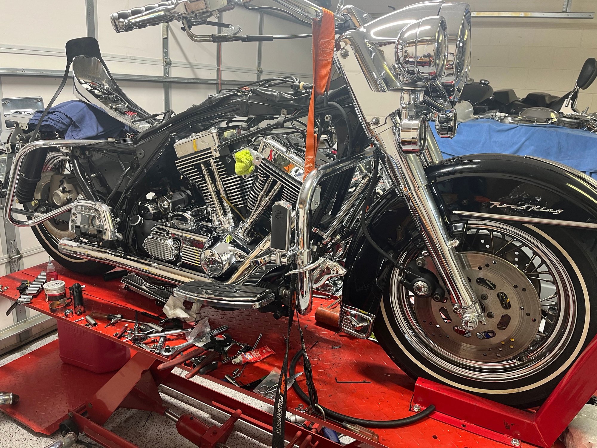

I tore the 113 motor down and rebuilt the 113 and put it in the Road king, changed tires, pipes, clutch, ignition.
Day I brought it home April 12 2024
After I cleaned it up and put the caddy taillights and fishtails on it
Putting the 113 in it

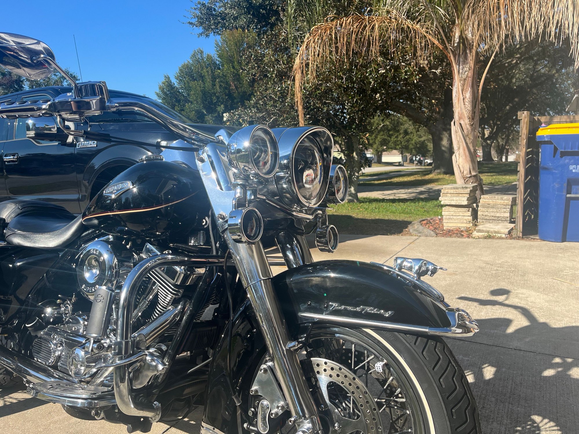

A few other additions cause I’m cool like that..
Headlight bezels and silver chrome lights, Four piston brakes.
Since the previous owner put the Bull heads on the crash bars I added the front fender Bull.
Love Love Love this bike, zero regrets. I paid 4k for it, got my 20k miles outta it. Built and bought the 113 for under $1400. I also rebuilt the shocks with progressive heavy duty springs, 20 weight oil, and redid the rear with 10 weight oil. … So for like $6500 I have this bike at 120hp/120 torque, great brakes and suspension!

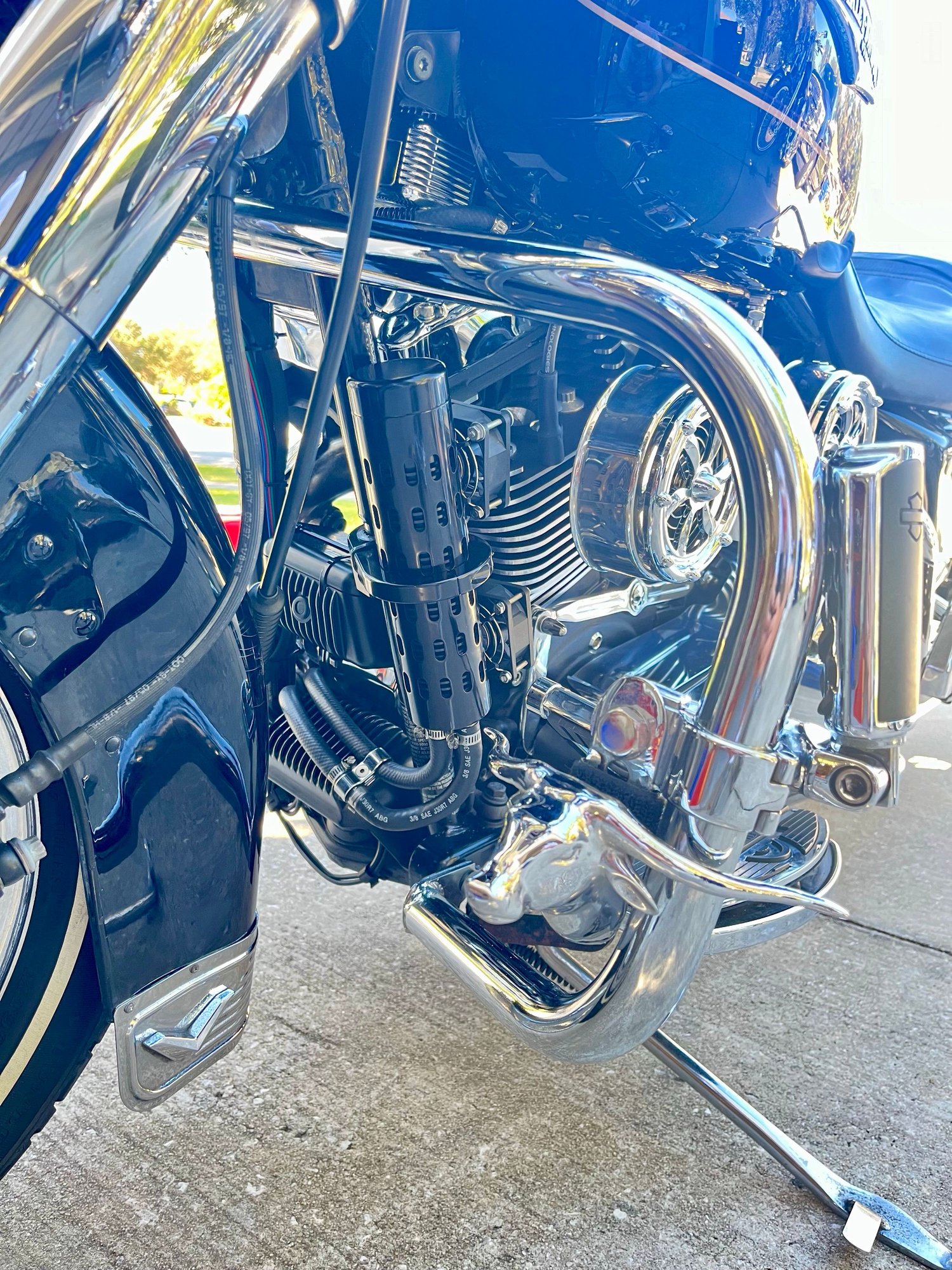

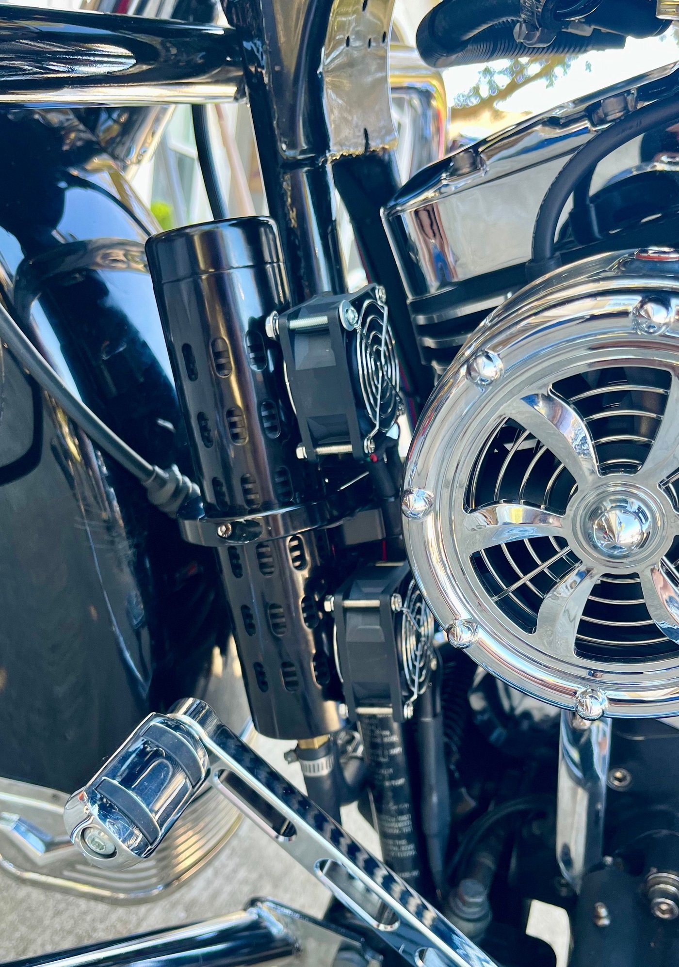

eBay oil cooler and Amazon fans rigged to a switch & market place love jugs… cheap cheap cheap. Like I said $6,500 all in, bike, rebuilt 113, rebuilt tranny with back cut gears, new tires, pipes, brakes headlights, doo dad’s.. all in.
