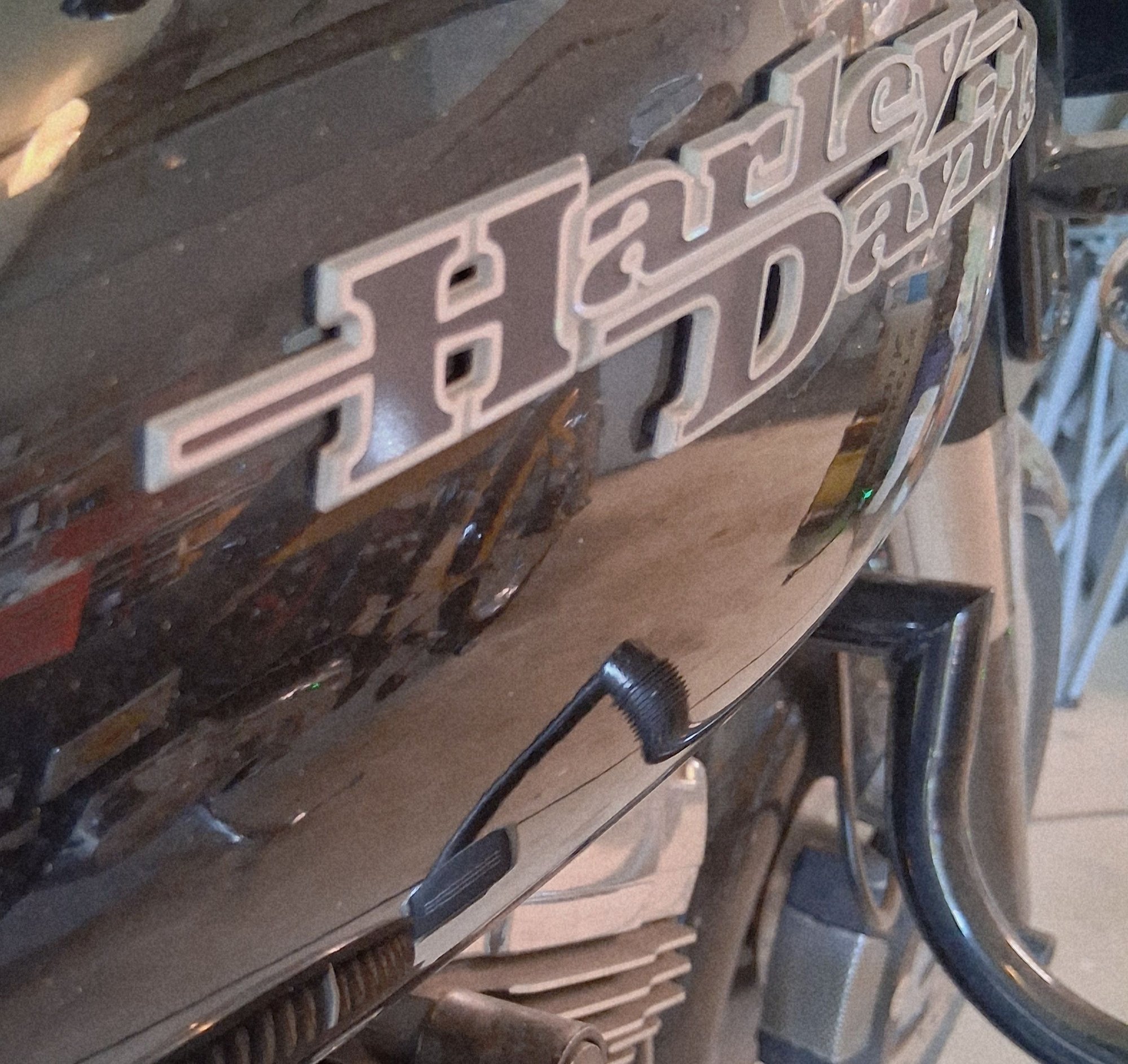

Question
Which of your bikes and year model are you talking about? A picture would be helpful to better understand what type of OEM Harley-Davidson emblem you're talking.
By saying "badges" I assume you mean the raised emblem type badge like the ones used on automobiles. The ones on a newish Harley tank are glued on (maybe they all are).
2012 FLHX
2012 FLHX
