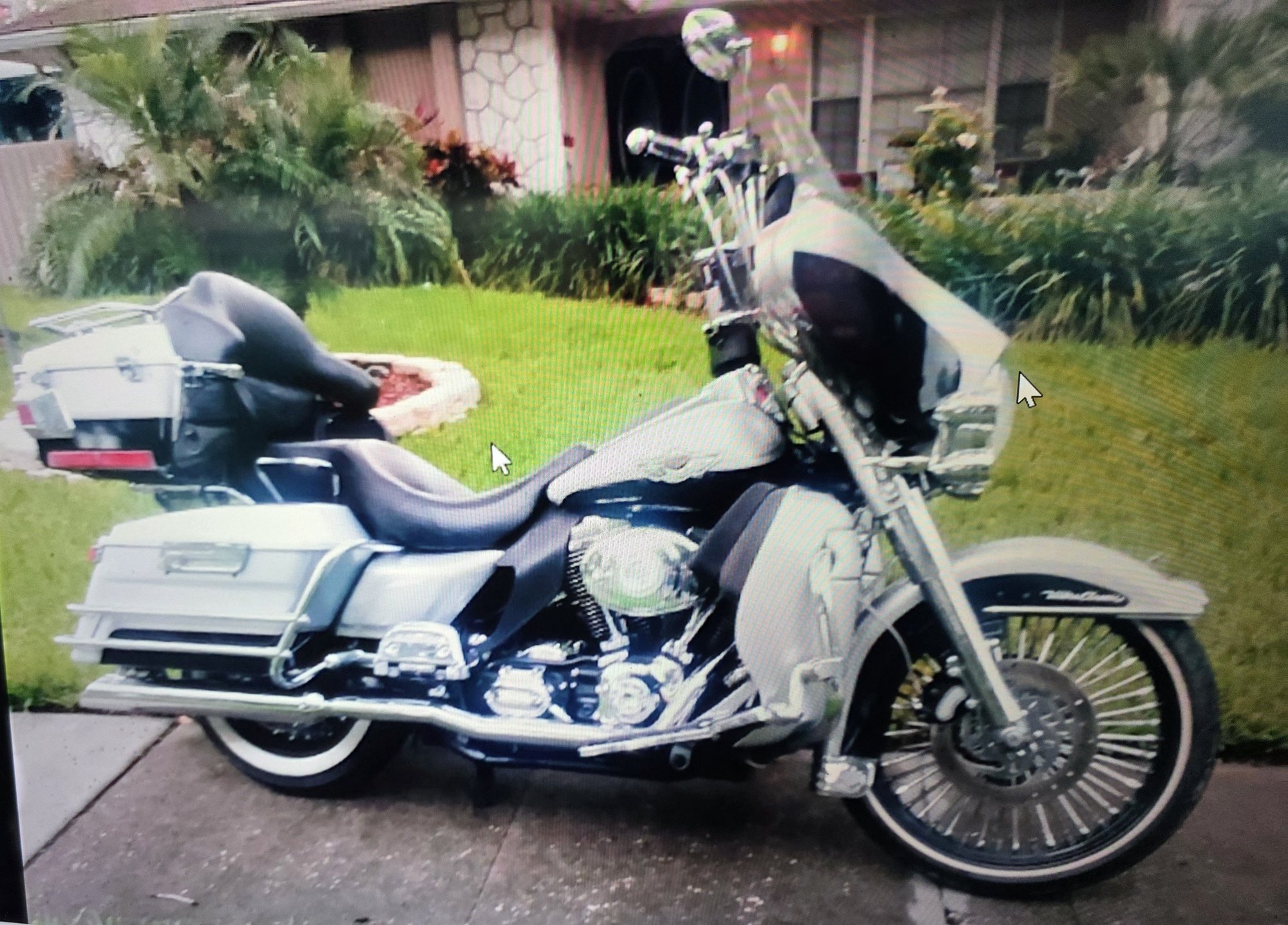

My 2003 Ultra between 2000 and 2500 RPMs has a flat spot, miss, sounds like lean pop, Cannot steady state cruise at that RPM. is fine below and above. Is a new thing after the bike was in the shop for a while. Bike is stock, shop said buy a tuner and tune it but the bike is stock and was fine for the 14 years I have owned it. it has air filter and exhaust, but has been fine with those with no tune. Could the stock ECM "lose it's tune". Seems wrong. I see used ECMs for $200. But seems weird the ECM would be out of tune for 500 RPM between 2000 and 2500 RPM. Looking for ideas what it could be NOT ECM related. Seems stupid to dyno tune a stock bike. Thanks in advance

So the speedo calibration is on Dakota Digital gauges that have been on the bike 10 years, the thinking was maybe the speedo was off affecting the cruise that was not working. Yes I tend to think it is something they fixed causing the issue as it was fine going in. However it was having an issue stalling sometimes if I let the throttle off quickly and went straight to idle, but would be fine when I restarted it. They fixed that, but maybe caused a new issue? No they did not quote a tune. it sounded like they did not want to F___ with it and denied the flat spot was as bad as it is. It is not so much letting off, it is accelerating if I am easy on it going through that 2000 range, and steady state cruising in that range. Is fine if I drive it like I hate it and low through that 2000 rpm range. Below and above 2000 are good. I kept all the paperwork of what they did. I will send it to another shop. I found out a couple nights ago the ignition was not locking with the key, and also had the speedo stay lit when I turned the bike off. Turned the ignition on and off again and it was fine. So there are some issues. Trying not to get pissed and go buy a new bike. But my bike is supposed to be a source of pleasure, not pain!

So the bike left the dealer brand new with the air filter and slip on and no tuning was done . The stalling was something that developed well after 100,000 miles of having the mods from new. The engine has never been open except for the preventative timing chain tensioner. The stalling was very intermittent, and the shop cured that but I do not see what they did on the invoices. But never ever had any issue at any rpm before. Always pulled and cruised smooth. I thought the idle stall issue could be the IAC simply because I could instantly restart it and it was fine, as if the IAC was reacting slowly. I completely forgot the bike got a new fuel pump and filter on this trip to the shop, maybe the fuel pump someone mentioned could be the issue, it acts like it is starving in that RPM range. I got caught up in traffic in Daytona last weekend and it did seem a little hotter than normal but I have not rode it in months so I was thinking maybe I was just being a *****!
