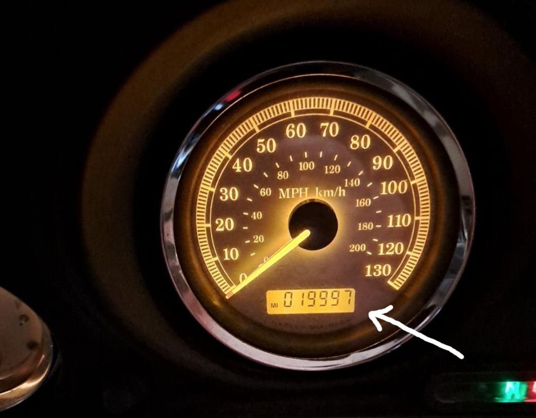

I've recently bought a 2007 Street Glide and I noticed that the trigger switch/ trip button has limited functions and no fuel range display. All previous H-D I owned (newer models) had more functions like total odometer, trip A, trip B, fuel range display and more.
I was wondering if there is an upgrage of the switch that adds fuel range on the odometer display?
Any help appreciated

07 didn't have fuel range and there is no way to get one in there. The ECM cant be programmed for that.

There are upgrades but I do not think they add much other than digits read outs. If you get rid of the radio, your Speed-O gains a clock.
