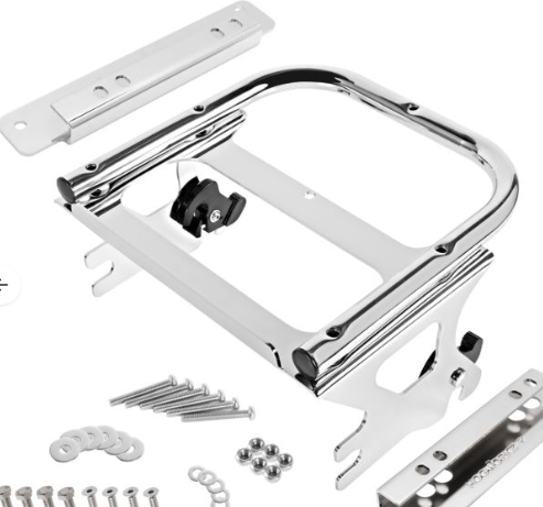

Hey to everyone,
Been a while since I have been on here. But I have a problem that I just can't solve yet.
I have installed a quick detach tour pack mount several years ago (Hogworkz). Everything was good for a while.
Now, the tour pack wobbles all over the place on the docking hardware. Thinking it was the hardware themselves. I purchased new hardware and bolts. Assembled everything. Still loose.
So, I then purchased the entire mount and docking hardware kit. Assembled all new. 2 rides in. Loose yet again. Tour you can grab the tour pack and wobble it about a 1/2. When riding down the road it just shakes like crazy at every bump.
Anyone have this problem? If so, how did you solve it.
I am at my wits end here and am thinking about welding up a bracket and bolting it to the docking hardware.

The black "bushings" in the mount are concentric. They look round but they are not. You rotate them to take out the slop.
That was my first thought also until I thought about how much it wobbles.
OP, does your tour back c-brackets that fit onto the bikes mount have the rubber grommets on them? They assure a tight snug fit.
If that is not the issue please post some pictures so we can get a better idea.

Chopper man. I look at the bushings. Mine measure round. I even have ones that are not installed, so they are new and they measure round.
Cosmic, the Hogworkz one that I have does not have the C that you are talking about. This is the 2008 and earlier mount See picture below

The bushing itself IS round, it is the center hole that is slightly offset which gives you the adjustment when you rotate it.

I don't know how the OP's mount is configured, I had the Harley quick disconnect mount. It had plastic bushings on the bolts the big C slots engaged. Over time the bushings wore or compressed and developed slop. I tried the suggestion of installing wire bundle ties that would fit in the slots of the plastic bushings and "shim them out" .That made the C slot fit so tight it was almost a permanent mount, but that cured the slop.
