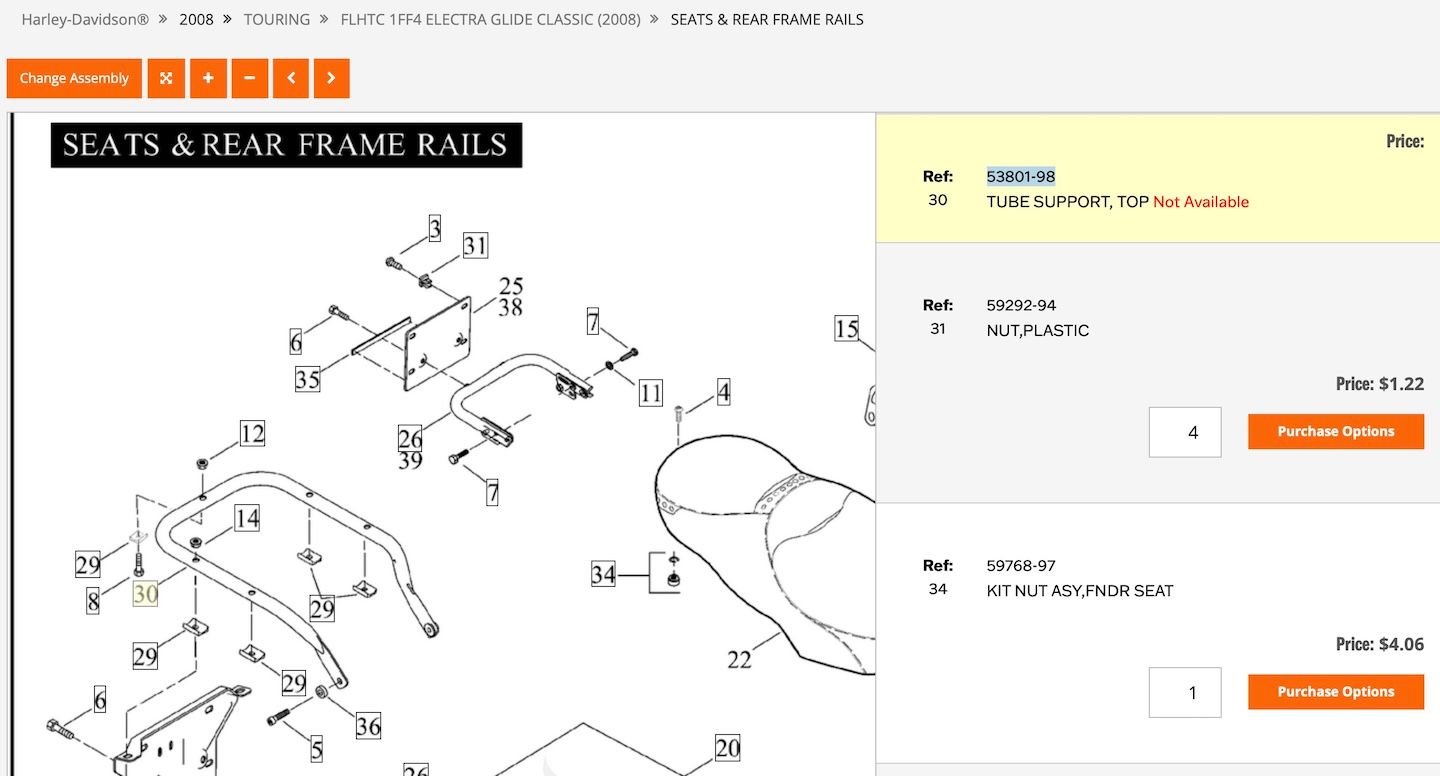

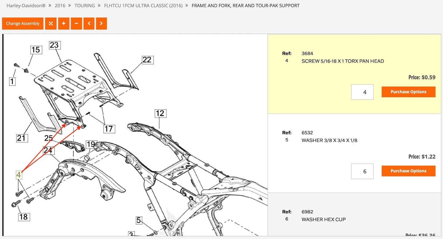

This may help...
I just realized your bike is a 2008. It is more complicated than my 2016... sorry to get your hopes up for an east on/off, but if you never remove the tour pack, you can still remount your tour pack as delivered from the factory with solid mounts, but it's a little more involved than mine..
I just checked on the online parts site, and confirmed your 2008 OEM brackets are different from my 2016 brackets... Your OEM solid bracket mounts are more involved than the 4 bolts of the 2016 solid mount system.
If you saved the OEM brackets when you added the quick release mechanism, you're golden. If you no longer have the OEM parts, and need to replace your solid mount system, you may have to work to find the parts.
My parts search also shows the 2008 OEM solid mount parts are obsolete. You'll need to look up the part numbers and search to find good used or NOS parts.
Here are two pics of the parts between our bikes.
Your 2008 uses a couple support tubes with associated hardware.
My 2016 has a tour pack bracket that just slides into a slot of the saddlebag support, then is attached to the fender struts with 4 bolts... much easier than your set up.
Again, sorry to get your hopes up for an easy return to OEM, but it is possible if you have (or can find) the parts...
I hope the above parts pics help..
