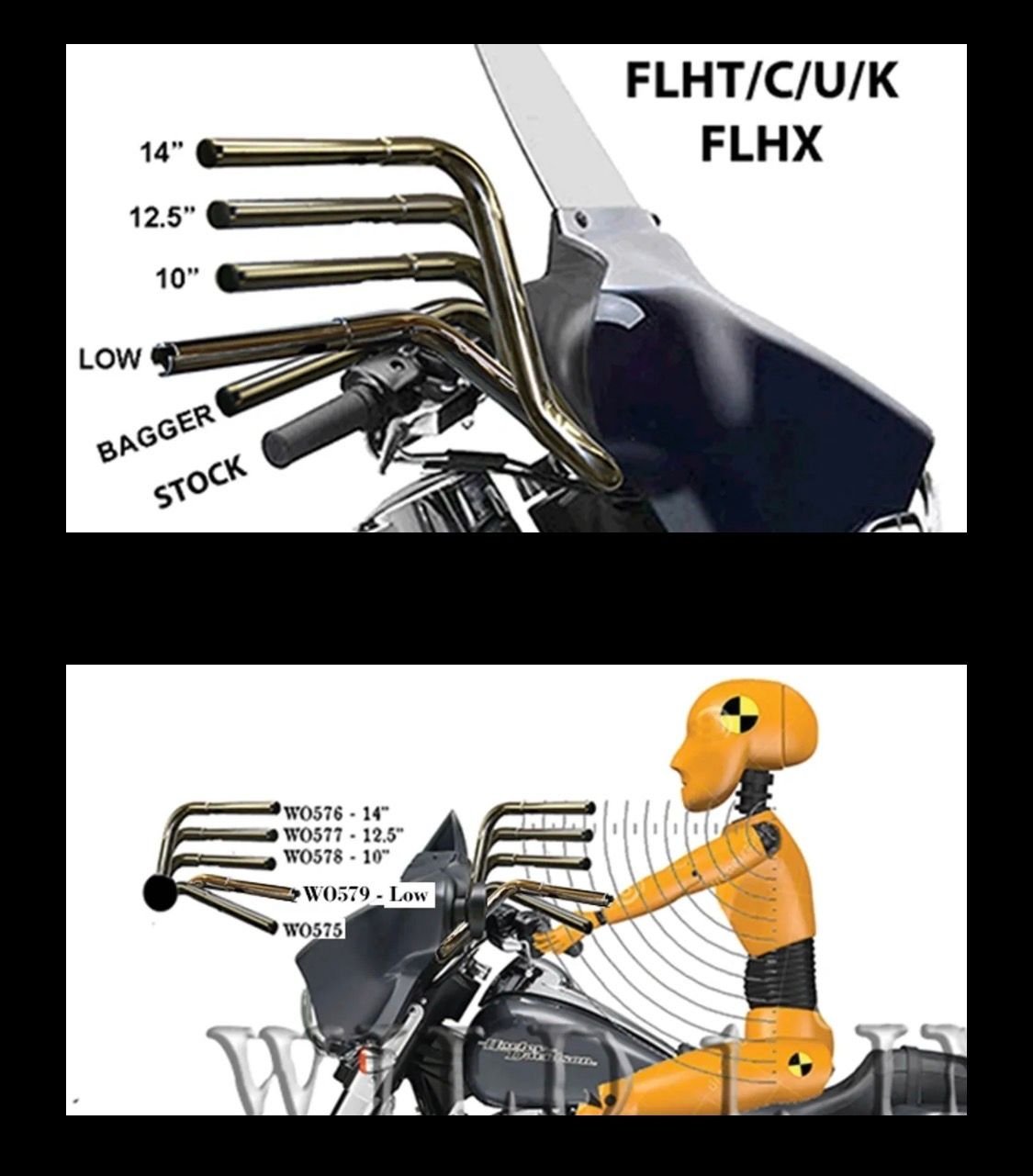

This should give you some idea where your grips will be in relation to the fairing.

You need to find the "pull back" position first. If you ride long distances just be aware that even though your hands are sort of "at rest" on the grips with your arms extended out at say a 90* angle from your body, a lot of that tension is transferred to your shoulders. So, my advice would be to find the most comfortable pull back so that your arms are not fully extended with forearms at about a 30* angle from your upper arm. Once you do that, you have also established the height. It's all geometry. It has been years since I replaced the stock bars (which were a terrible fit) on my '05 FXSTD for a set of Ness Lo Fly bars. I developed a spread sheet with a variety of stock and aftermarket handlebar specs; length, rise, pullback, etc. then visited one of the local dealerships, grabbed the bars on display and sat on the bike with the bars situated as best I could to simulate the actual fitment. That narrowed down the field significantly. From that trial/error session, I settled on the dimensions I needed and started looking for a set of bars close to those dimensions which led me to the Ness bars.
I know that sounds like a lot of work, took a long time, which it did; however, I can tell you that if you get it wrong, it won't take long for your body to let you know. JMHO but bar location and fitment to the rider is as important to seat selection; the go hand in hand. Good luck with your search.
