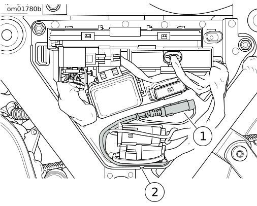

You bike left the factory with a factory installed tender connector under the left side cover below the main fuse.
See #1 in the pic below.
#2 is a slot that the connector can be routed through in order to access without removing the side cover.

The plug you have circled in Red is not the tender plug.
Looks like someone has moved the actual tender plug to rest outside of the cover.
See it circled in Yellow.

Ha! Dang, well at least my semi-blind picture served its purpose after all. Thanks man!!
Seemed very odd it wouldn't have one. I appreciate it.
