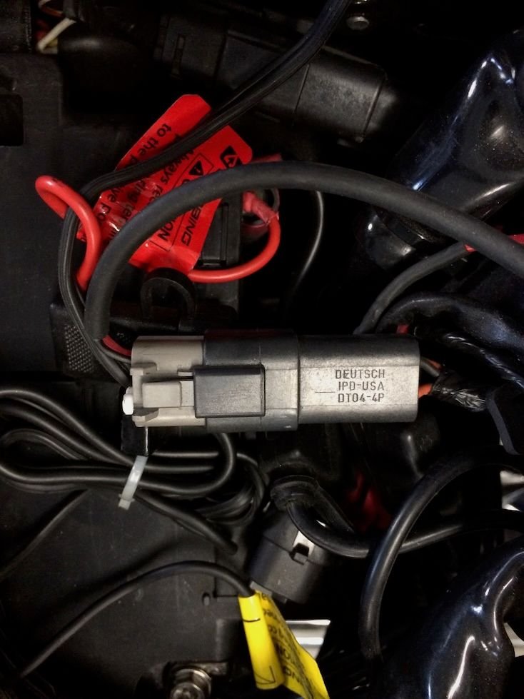

Old Mar 11, 2026 | 09:58 AM
RKZen's Avatar
RKZen
Joined: Aug 2013
Posts: 6,088
Likes: 1,962
I have a '13 King and I have the 4-pin connector as mentioned and below pic. The seat fitment should be fine, but double check if the connection for the seat is 6-pin or 4-pin. Someone can confirm, but I think the 2014+ bikes are 6-pin, but I could be wrong.

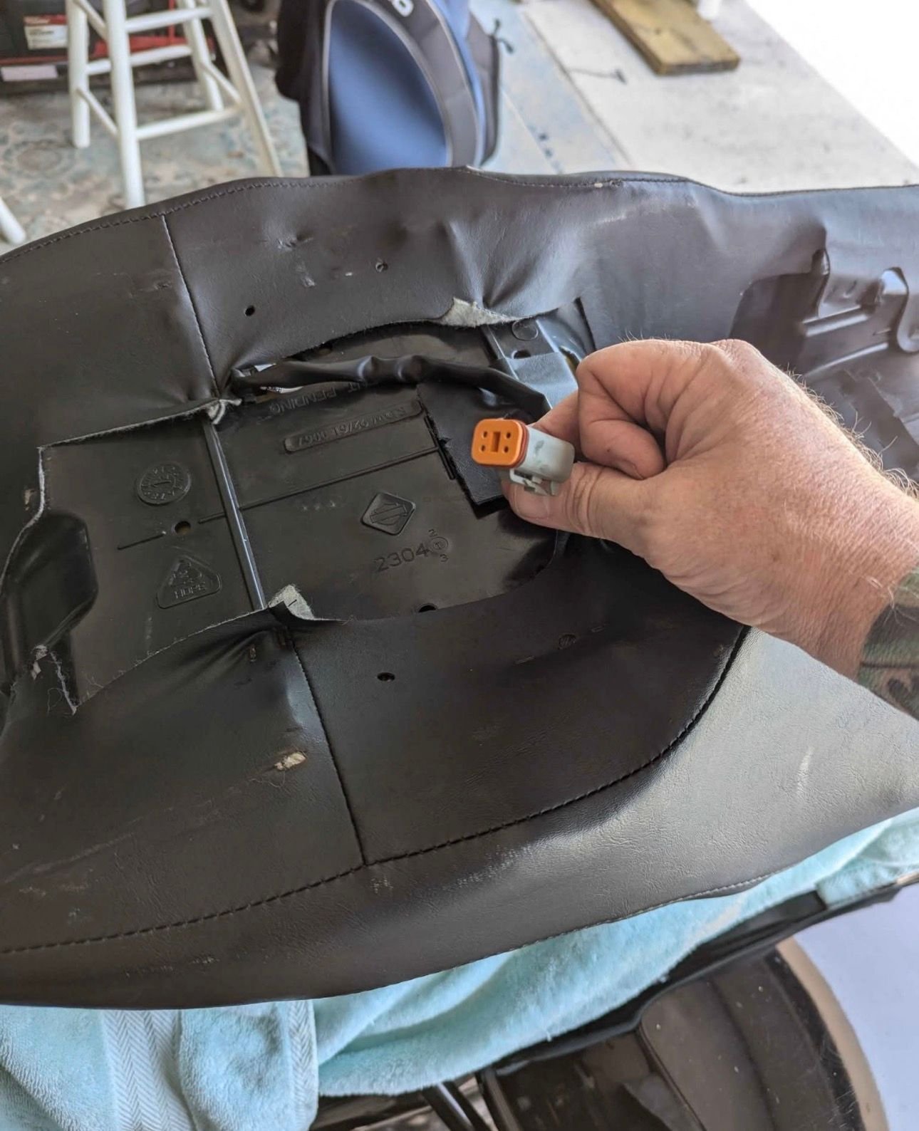

Old Mar 11, 2026 | 08:01 PM
bubdifab's Avatar
bubdifab
Joined: May 2007
Posts: 277
From: Jersey Shore
looks like I should be good to go. This is the connector for the seat.
