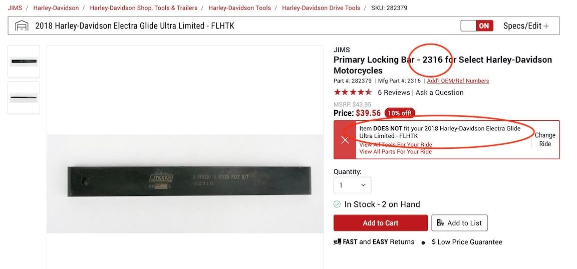

That locking bar link comes back on a JIMs # 2316 locking bar for a 4 or 5 speed FXST when I hit the link.... That won't fit your bike...
OP, the locking bars come in different lengths for various transmissions, & primaries.
I bought a set of 5 different sizes, several years ago. I think it was before the M8s came out. They were for 4, 5, and/or 6 sped trans, for Dynas, Touring, and/or Softails:
5.625" - '07+, 6-speed FLHR, FLHX, FLHT, FLTR
5.950" - Late 6-speed FLH
7.125" - '06+ Dyna & '07+ Softail
7.601" - 5-speed FXR/FLT
8.500" - 4-speed/ 5-speed FXST
I have not needed to use a locking bar on my new-to-me M8 touring bike. I haven't had the opportunity to even try any of the sizes I currently have, to see what may fit, on my M8 touring primary.
A search found that "Google AI" said the the M8s take a 5.625" - 5.950" locking bar, but we all know how inaccurate Google AI can be...
OP, make sure you get the right size for your 2018 M8 Touring bike....
Hopefully some one can give us the exact size needed.....
This is how they are used...
PS- I found a JIM'S Tools locking bar, #2320, for an M8 Softail, but I couldn't find its size. It also doesn't say for an M8 FLH, so I would think it wouldn't fit.
Again, "Google AI" says it 8.25" long. If true, I doubt that will work on an M8 touring bike, but I really don't know...

They are all over ebay and amazon. The proper one for your bike is 5.95 inches.

I might add, the locking bar in the picture is positioned for tightening the comp bolt. It must be oriented with front end lower and the back end higher for loosening the comp bolt. You would probably figure that out very quickly, but this might save a little early frustration.
