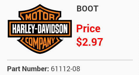

Any one know the part number on that rubber gasket for the filler neck.

This is a great website that I continue to use for part numbers... http://partsfinder.onlinemicrofiche.....asp?make=hdmc
