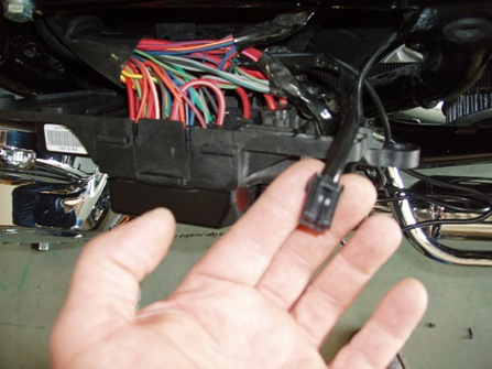

I am installing an Ultra Tour-Pak with the additional lights on my 09 SE Road Glide and have a slightly different issue. I have located a 3 prong plug by the fuse box and it has the same wire colors as the main harness (1 blue, 1 black and 1 red with a yellow stripe) so I thought I had the correct plug. Also, the harness doesn't appear to have any slack wire; just a short pigtail about 4" long. When I check the output with a test light, I have 1 wire that's live, but don't get anything for signal lights. I took the harness out of the tour-pak and connected it up. No signal lights!
Any ideas?

The black wire is ground; the blue is "run" light (energized when ignition switch is "on;" and, the red/yellow wire is brake light) energized when ignition is "on" and front or rear brake engaged.
It should be a simple matter of plugging the tour pak harness that's on the bike (usually located under the left side cover, coiled and zip-tied) to the tour pak's wiring harness.
Personally, I'm not familiar with the SE Road Glide's wiring, but typically that wiring is part of the bike's main wiring harness and would be the same as an FLTR. My local dealer has an '09 SE RG in for service so I'll see if I can take a look at it tomorrow.

Probably just a goof on my part; I assumed that with dual filament bulbs there would be signal lights. The running and brake lights work fine when I plug them into the available pigtail. Would still need to buy or build an extension from the pigtail on the bike to the tour-pak.
My 09 SERG doesn't have a seperate brake light, just left and right dual intensity LED's so I may rewire the tour pack to have running, brake and signal lights on the tour-pak.

I wish my 09 SE had the longer harness but it doesn't. The pigtail is only 4 or 5 inches long.
I have attached 2 photos showing the pigtail.
