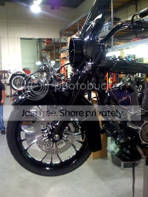

I've been powder coating since 1999 and can tell you that the 400 degrees required to cure powder coating is not enough to warp even the thinest strip of metal. I've done lots ofheadlight/fog light visors with absolutely no problems. I mentioned them because I think they are the thinest metal parts on a bike. You won't have any problems.
Show us some pics!

Looks like you did the whole windshield bracket........... cool........ mine looks like your except no custom wheels. stock black 9 spoke for me...What about the turn signals....just take them apart and powder coat them....any tricks.....thanks
