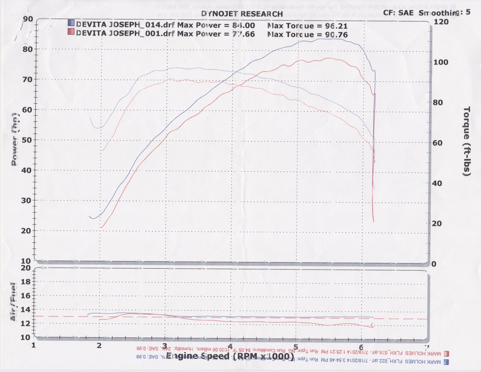

D&D Fatcat 2:1, Roland Sands Clarity air cleaner. Screamin' Eagle Race tuner.
